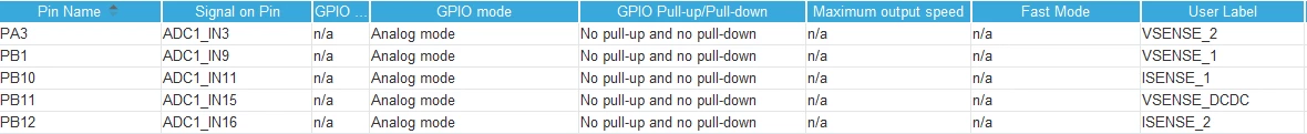

Hello, is there any information for which Pin to check and what voltage is in STM32G081B-EVAL\Applications\USB-PD\USB-PD_Provider_1port?
And I tested the callback function USBPD_DPM_UserCableDetection won't be tigger.
Yohann M.
Yohann M.Best answer
Dec 2, 2019 12:27 PM UTC
EVAL-G0 description with extension board MB1350 is available in UM2403.
