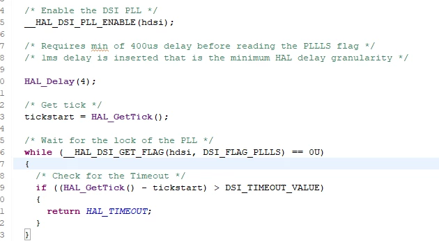

Sep 23, 2024 8:54 AM UTC
Hello @99_it and welcome to the Community ;
Could you please refer to DSI example and check the PLL configuration. may this example can help you.
Please make that the HSE is ON and READY before starting DSI (as DSI PLL source is HSE).
Please try to increase the delay before verifying the PLLLS flag (3ms for example).
I hope this help you.
Please let me know if the issue is solved or not?
Thank you.
Kaouthar

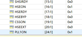

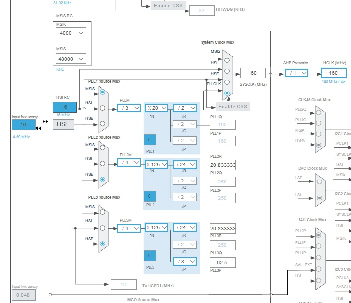

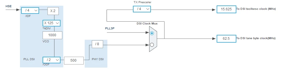

99_itAuthor
Sep 24, 2024 12:48 AM UTC
it does not work .
i check the colock is same with DSI example.21.png屏幕截图 2024-09-24 084815.png
