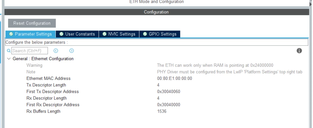

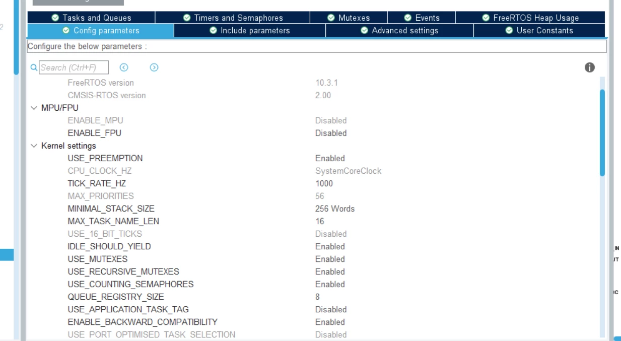

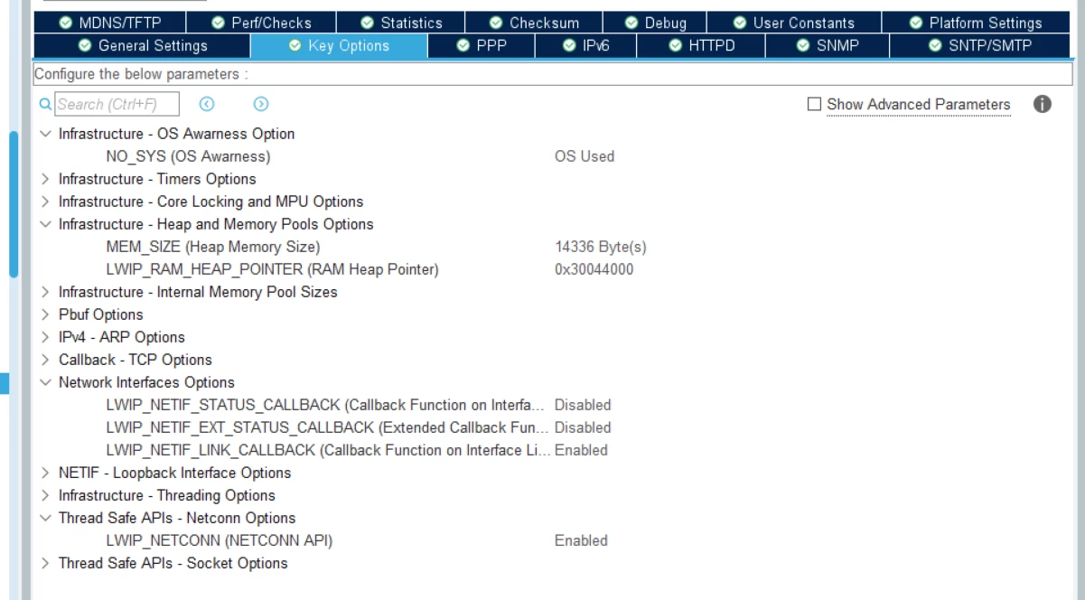

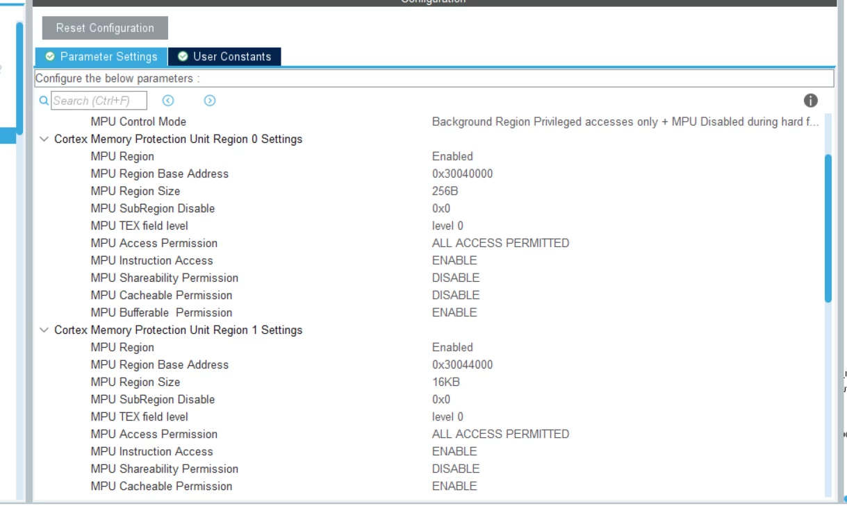

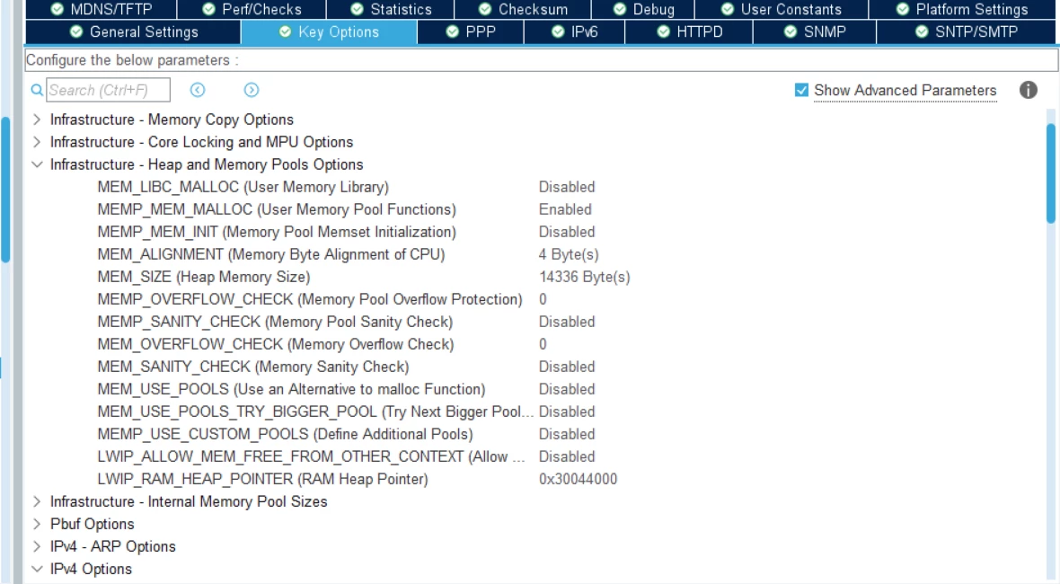

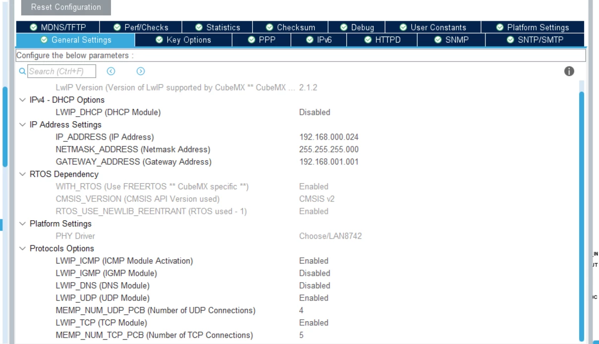

When configuring the STM32H743IIT6 chip with LwIP and FreeRTOS using STM32CubeMX, it cannot be pinge
The following are some configuration parameters:

Could you please check Cortex-M7 configuration and LwIP configurations.
For that I recommend you to follow the steps shared in How do I create a project for STM32H7 with Ethernet and LwIP stack working? FAQ.
Also, STM32H743_Nucleo_ETH example may help you.
I hope this help you.

Hello @lekaho
I encountered a similar issue with the STM32F107 on the community forum STM32107 + LWIP2.0.3 + FreeRTOS CMSISV1. I created a new project using the latest CubeMX version 6.11.0 and CubeIDE 1.14.0, which proved to be successful. It is recommended that these LWIP with FreeRTOS examples on GitHub NUCLEO-H743ZI LWIP Applications  be employed to compare the configurations with those of your project.
If the problem persist, it would be beneficial to provide further details on the setup project and, if possible, the .ioc file/configuration.
