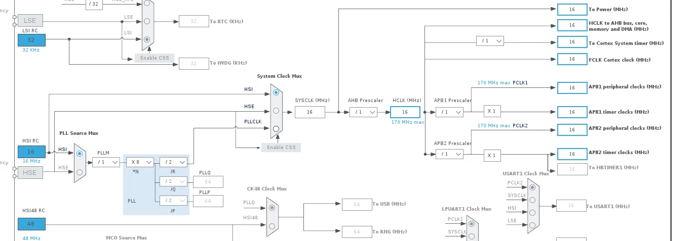

AScha.3
Nov 20, 2023 5:59 PM UTC
i am just guessing:  might be, what CubeMx shows, when you start a project (and set nothing)
HSI driving core and bus...otherwise no start code/your code could start ever.
