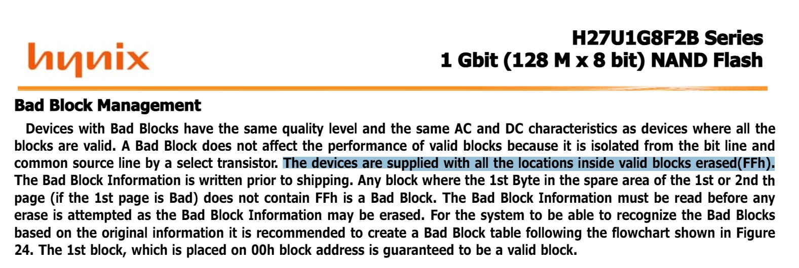

I want to access a NandFlash(H27U1G8F2B) chip which is extended by STM32F429BI's FMC;
According the datasheet, seems the default value after erase is '1' for each bit.

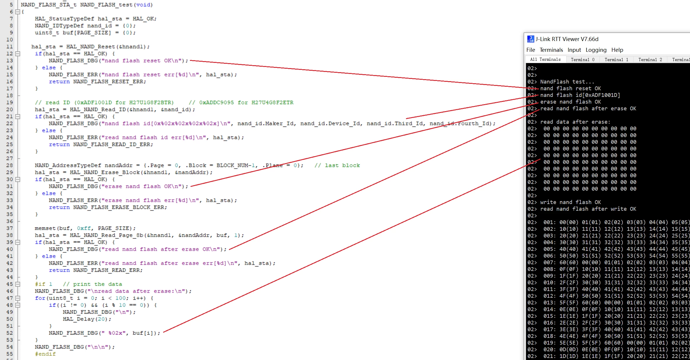

But I read the value by program is '0':
My test code as below:

You can check the LOG that I can read/write the NandFlash normally.
