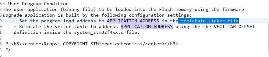

What is �?toolchain linker file】mean?
Hello everyone, when I was watching the stm32f429 routine, there was an example of upgrading the user program with the U disk. It was mentioned that the configuration of the user program needs to change the contents of the [toolchain linker file]. Where is the [toolchain linker file]?0693W00000QOGveQAH.png
2 replies
Tesla DeLorean
Guru
Aug 23, 2022 5:43 AM UTC
A .LD file under the project directory describing the memory available for the linker to use.​
