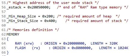

What is the simplest approach for 1-bit shared memory between bootloader & application?
I am trying to get an application to set a flag to non-volatile memory to communicate to the bootloader after reset to reprogram the application image. I am using the STM32L496 MCU.
EEPROM seems to be the weapon of choice, but our team has EEPROM on both the application and the bootloader configured to use "virtual eeprom" (which basically means it is actually using flash) and from what I can tell can only be used within their respective programs.
What would be beautiful is if the MCU had a spare non-volatile register (like the RCC_CSR register) that can be used to share a 1-bit flag between the applications to communicate when it is time to reprogram the image.
What is the simplest method for tackling this problem? Example?
Thanks,
Marshall

You could move the stack pointer down and shrink the RAM by 16 bytes or whatever.
*((uint32_t *)0x20004FFF0) = 0xABBAACDC;
Between you writing it and doing an NVIC_SystemReset() and entering Reset_Handler is a pretty short walk. The MCU does not clear memory, startup code potentially can but only that visible to the linker.
The RTC has 128 bytes of backup registers, perhaps look at related examples and RM. The linker has no awareness of this memory
void HAL_RTCEx_BKUPWrite(RTC_HandleTypeDef *hrtc, uint32_t BackupRegister, uint32_t Data);
uint32_t HAL_RTCEx_BKUPRead(RTC_HandleTypeDef *hrtc, uint32_t BackupRegister);
On parts like the L1 and L0 there is actual EEPROM if this needs to survive a power cycle, and you have not backup supply.

If it's a simple reset you can just store magic values in RAM, could use registers in RTC also.

How would I store data to RAM and be able to recover it? Can you suggest a safe address for my application? This is the RAM allocation as defined in the linker file for both the bootloader and the application. Obviously the flash addresses are different. Do I allocate (aka "carve out") more memory?
