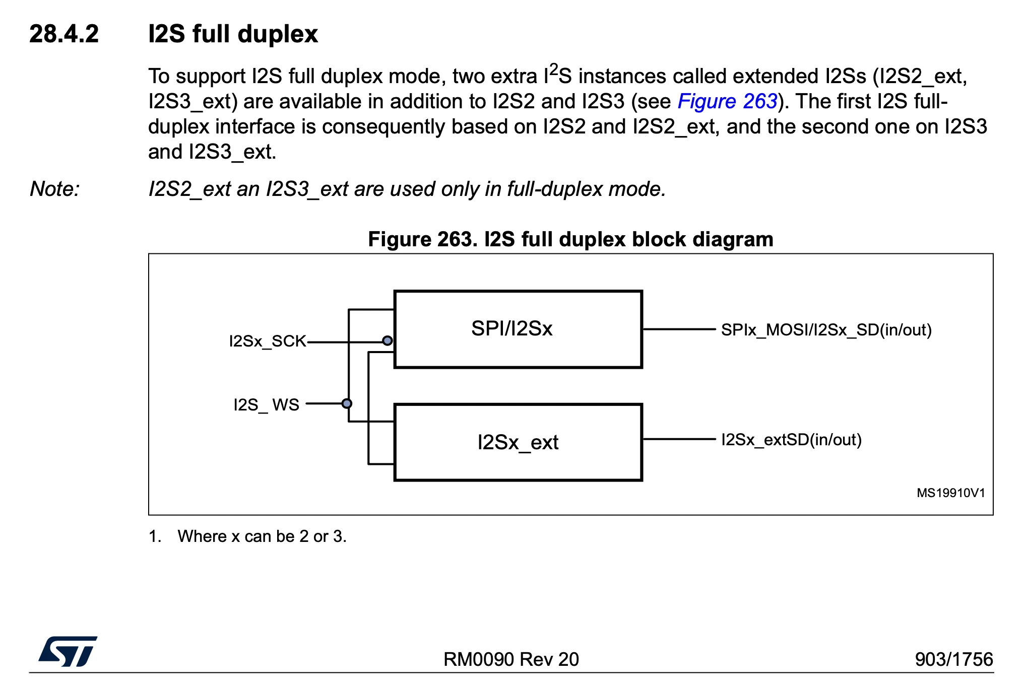

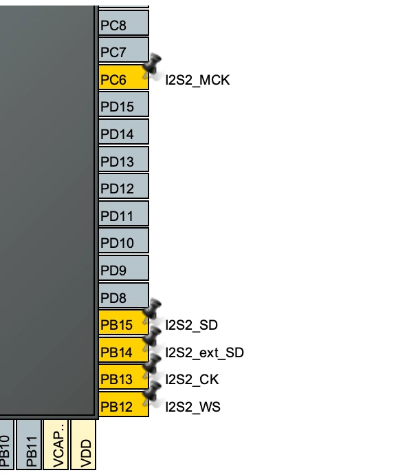

Please excuse the basic question, I am reading the datasheet of stm32f429ve trying to understand which pins I need to send data from the microcontroller to an audio codec using I2S.
I understand the I2S interface requires three pins, with an optional fourth pin:
  1. Bit clock, using PB13 = I2S2_CK
  2. Word clock, using PB12 = I2S2_WS
  3. Serial data, using PB15 = I2S2_SD
  4. Master clock, using PC6 = I2S2_MCK
However, I do not understand the function PB14 = I2S2_ext_SD.
Is this dependent on whether the pin is transmitting or receiving like MOSI or MISO in SPI? I cannot find this documented anywhere which makes me think it must be obvious :)

read rm ...
So for full duplex I2S you need two data lines : in and out.
Just set it in Cube and you see... or rtfm.  :)

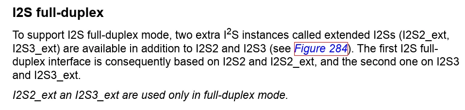

Codec means "a combination of ADC and DAC", thus requires data in both directions, i.e. fullduplex ("both MOSI and MISO" in your SPI analogy).
If you need only to *send* from microcontroller, it's then not a *codec* but a DAC. In that case, you need only one data line.
The SPI/I2S module in STM32 is only simplex when it operates in I2S mode, i.e. it has only one data line. To support full-duplex I2S,  for some SPI/I2S modules 'F429 (and a few other STM32) incorporate a second, simplified SPI/I2S module called I2Sext, which has only I2S mode (no SPI mode) and its clocks (WS and CK) are internally interconnected to its "partner" SPI/I2S module.
So, if you need fullduplex I2S, you'll need both I2S2_SD and I2S2_ext_SD (and you'll need to set up both SPI2/I2S2 and I2S2ext). If you need only simplex I2S, you don't need I2S2_ext_SD.

exlabsAuthor
Apr 30, 2024 4:46 PM UTC
Thanks for the really helpful advice everyone, that is totally clear. I was searching the PDF and didn’t find that diagram, will be less lazy next time :)  because it is not in the data sheet. Instead it is in the Reference Manual RM0090 and appears to be slightly different.
