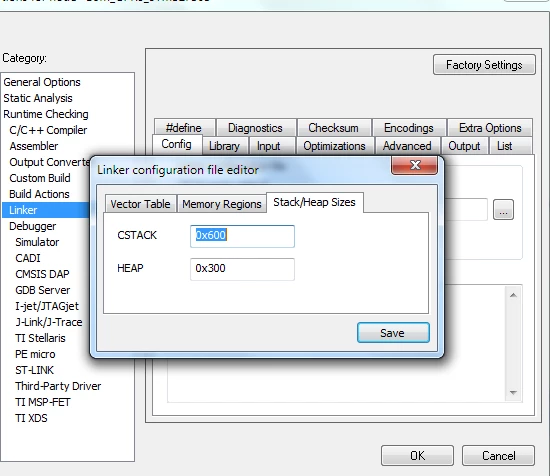

What is the correct CSTACK and HEAP for STM32F303cc ?
Posted on February 05, 2018 at 11:28
Our embedded application keep crashing
VListinsertend
after some time of operations. FreeRTOS code is generated using CubeMx.   What could be the possible issue ?
FreeRTOS details
FreeRTOS 8.2 with heap 4 , Systick timer
osThreadDef(Task1, StartTask1, osPriorityRealtime, 0, 256);
osThreadDef(Task2, StartTask2, osPriorityHigh, 0, 196);
osThreadDef(Task3,StartTask3, osPriorityRealtime, 0, 256);
osThreadDef(Task4, StartTask4, osPriorityAboveNormal, 0, 196);
http://www.st.com/en/microcontrollers/stm32f303cc.html
256 Kbytes of Flash memory
40 Kbytes of SRAM
What should be the ideal CSTACK and HEAP size for the this kind of applications ?
Custom size cstack and Heap
Can anyone guide us in the right direction on how to find the right size of CSTACK and HEAP for the application ?

The STACK in this context is probably just what's need to start all the other tasks, and those allocate theirs from the HEAP.
You, as a developer, need some conception of what demands your code generates, the call depth of your routines, the auto/local variable usages, and the expectations for malloc/free dynamic allocation of resources.
