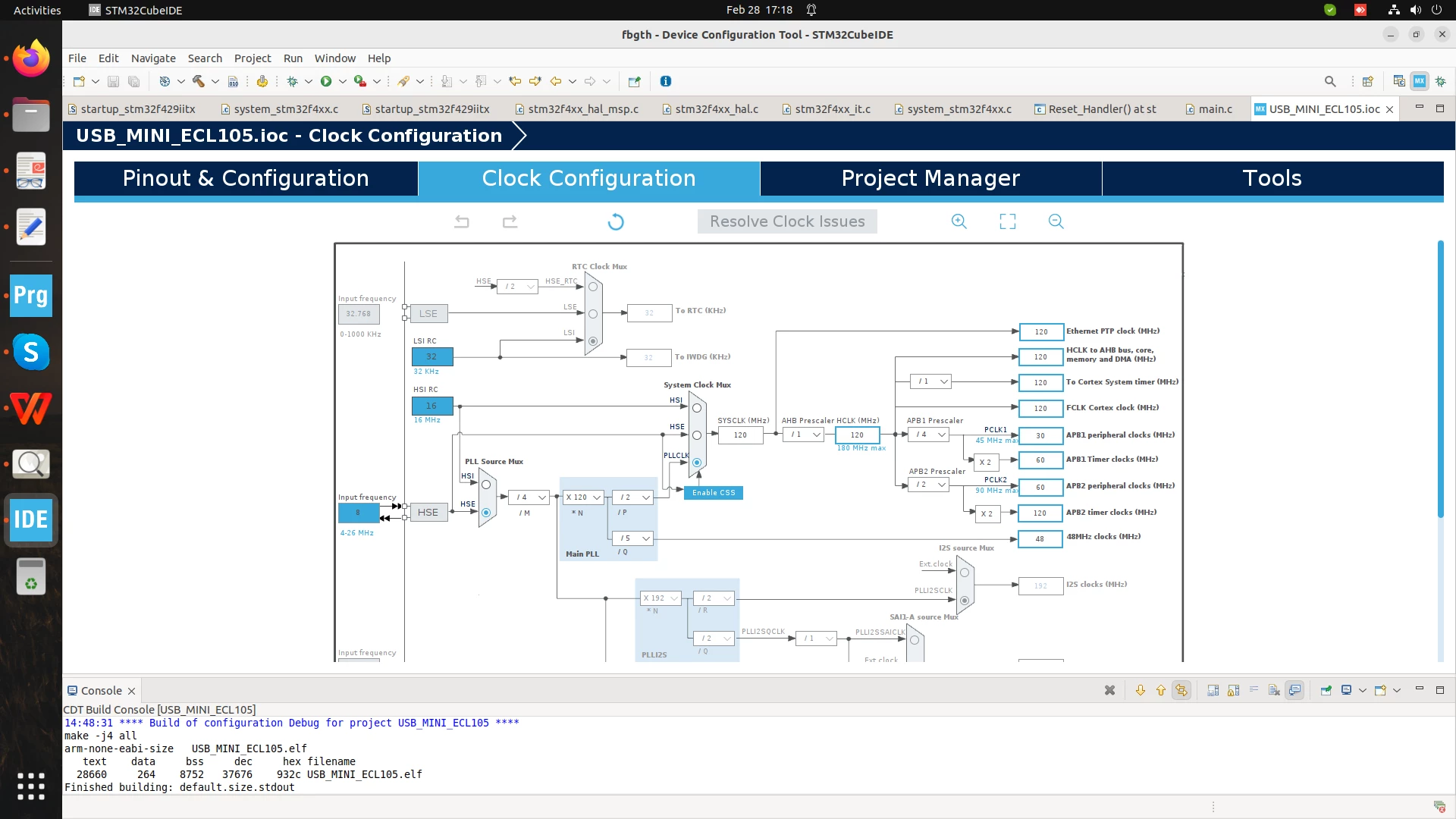

pshin.2
pshin.2Author
Feb 28, 2023 11:49 AM UTC
Thank you for your response.
I have checked the clocking too , it is correct. not working as in PC is not able to recognize the USB and i have also tried mass storage with USB but it is still not helping me enough.
I am attaching CLK config for your reference.

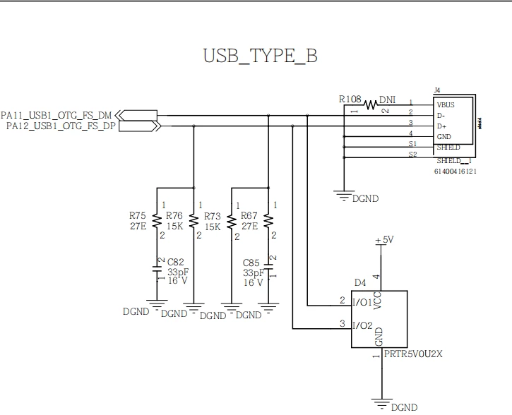

pshin.2
pshin.2Author
Feb 28, 2023 12:51 PM UTC
All other peripheral works fine only USB does not work0693W00000aHqWHQA0.png . I attached schematic of USB also please go through it once
gbm
Feb 28, 2023 3:30 PM UTC
Check the clock source. On Nucleo, it's external 8 MHz generator (NOT crystal by default), don't know about your board.
