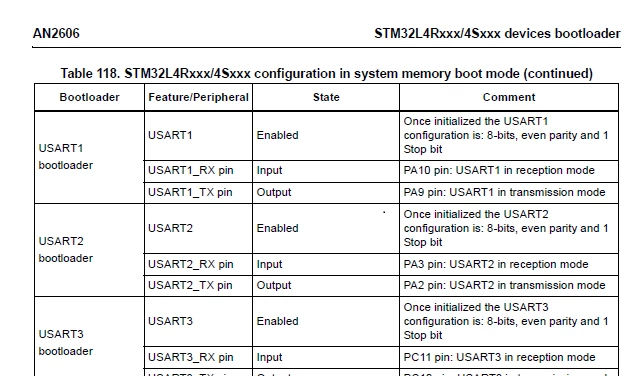

what happens when the CPU enters the default bootloader?
AN2606 lists all peripheral units that are always re-initialized (e.g. UART, SPI, I2C, ..)
What happens to the other ports and GPIOs (e.g. Port E/F/G)? Are all GPIOs reset or do they keep their last status?
I want to update from another chip via USART3, but the voltage supply of the chip is at port G. It is necessary that a pin is in a high state. If I jump into the bootloader, the pin is in reset state and the voltage is switched off.
I have already tried to jump into the bootloader with the option bytes and with a direct jump to the memory address. It also works on another board, but the power supply does not depend on a GPIO there either
Is there an application note that describes what the default bootloader does with unused GPIOs? Or do I have no chance and have to write my own boot loader that necessary GPIOs remain in their state?

If you started out the Bootloader from reset,all other GPIO should be in their default state. If you jumped to the bootloader from your user program, other GPIO might keep the state they had in your program.

It only enables clocks and peripherals it is using, if it uses PC11 I suspect it enables the clocks and blind writes into registers it assumes are at reset defaults.
If you use HAL_NVIC_SystemReset() that's obviously going to reset all the HW registers/settings.
If the system loader doesn't work as you want your options are to use your own loader, or perhaps patch the system loader, or select secondary entry points.

You can disassemble or single-step the bootloader to see what does it exactly do.
I personally wouldn't rely on that, though; ST may decide to change the bootloader in the future. In other words, if the behaviour of the default bootloader does not suit your purposes, you ought to write your own.
