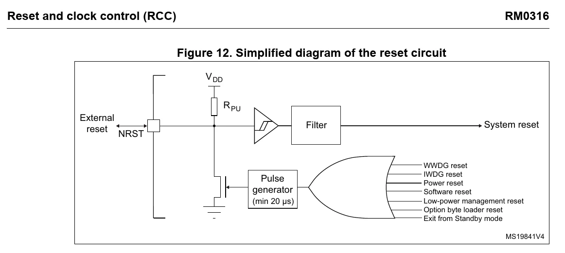

so here from ds+rm F303 , cortex M4 core :
reset:

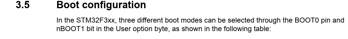

0693W00000Y6psWQAR.pngand boot mode set:
  • reset min 20us , to be shure, i would make 10ms and fine.
  • boot is set after 4 sysclks after reset...i would make > 1ms and fine.
  • to be shure, for your different chips, look in the respective manuals (timings might be different)
