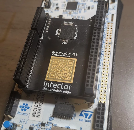

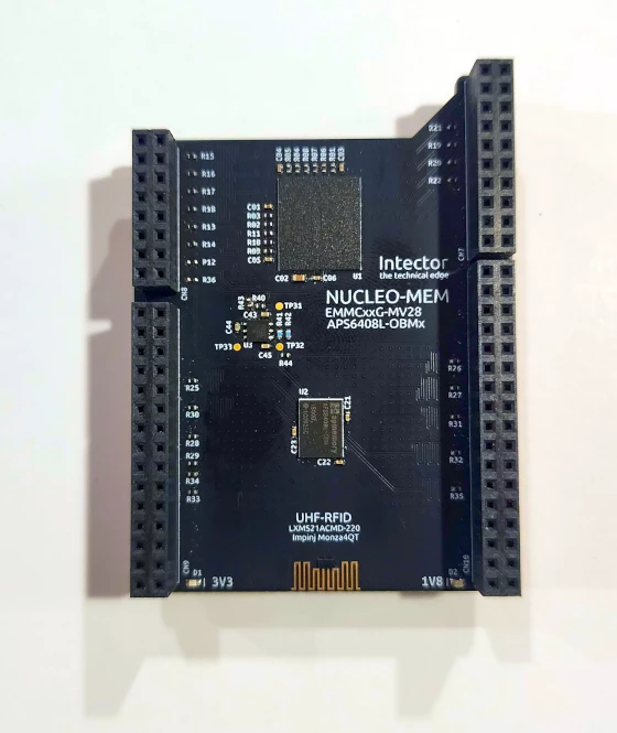

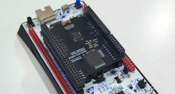

The Hardware: NUCLEO-MEM
Rather than keep working around the NUCLEO-144 limitations, I designed a purpose-built memory expansion shield that plugs directly into the Morpho headers.
[INSERT IMAGE: pic_01.png — PCB front and back]
The NUCLEO-MEM carries:
  • 8 GB eMMC (Kingston EMMCxxG-MV28) — connected via SDMMC1 (8-bit). Stores the web interface files (HTML, CSS, JavaScript) and provides gigabytes of datalogging capacity.
  • 8 MB Octal SPI PSRAM (AP Memory APS6408L-OBM) — connected via OCTOSPI1. This is the memory that Azure RTOS actually needs to breathe.
  • UHF RFID (Impinj Monza4QT) — unique device identification at up to 10 meters.

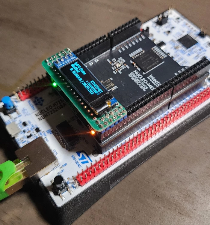

In the photos you'll also see an SSD1306 OLED display (128×32, I2C) — that's a separate module plugged into the NUCLEO-MEM headers, not part of the shield itself. It shows network status, IP address, and runtime information.
The NUCLEO-MEM requires an MCU with an OCTOSPI peripheral for the PSRAM interface. It has been validated on the NUCLEO-H723ZG (STM32H723, Cortex-M7, 550 MHz). MCUs without OCTOSPI — like the STM32H753 with its single QUADSPI limited to flash memory — can't use the PSRAM portion. For those boards, I have an earlier EMMCxxG-MV28 shield that carries only the eMMC storage — no PSRAM, but it gives any MCU with an SDMMC peripheral access to 8 GB of FAT-based file storage for datalogging, web hosting, or automated data offload via FTP.
 Designed in Altium Designer, four-layer PCB, all 0402 passives, impedance-controlled memory traces.

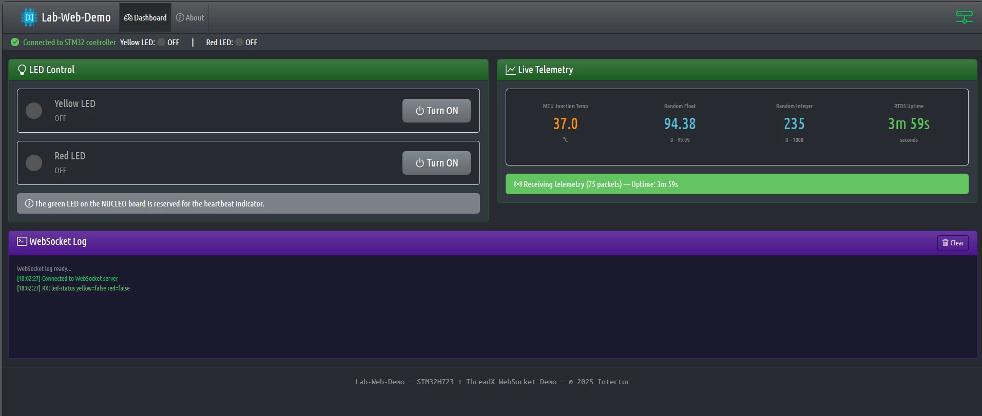

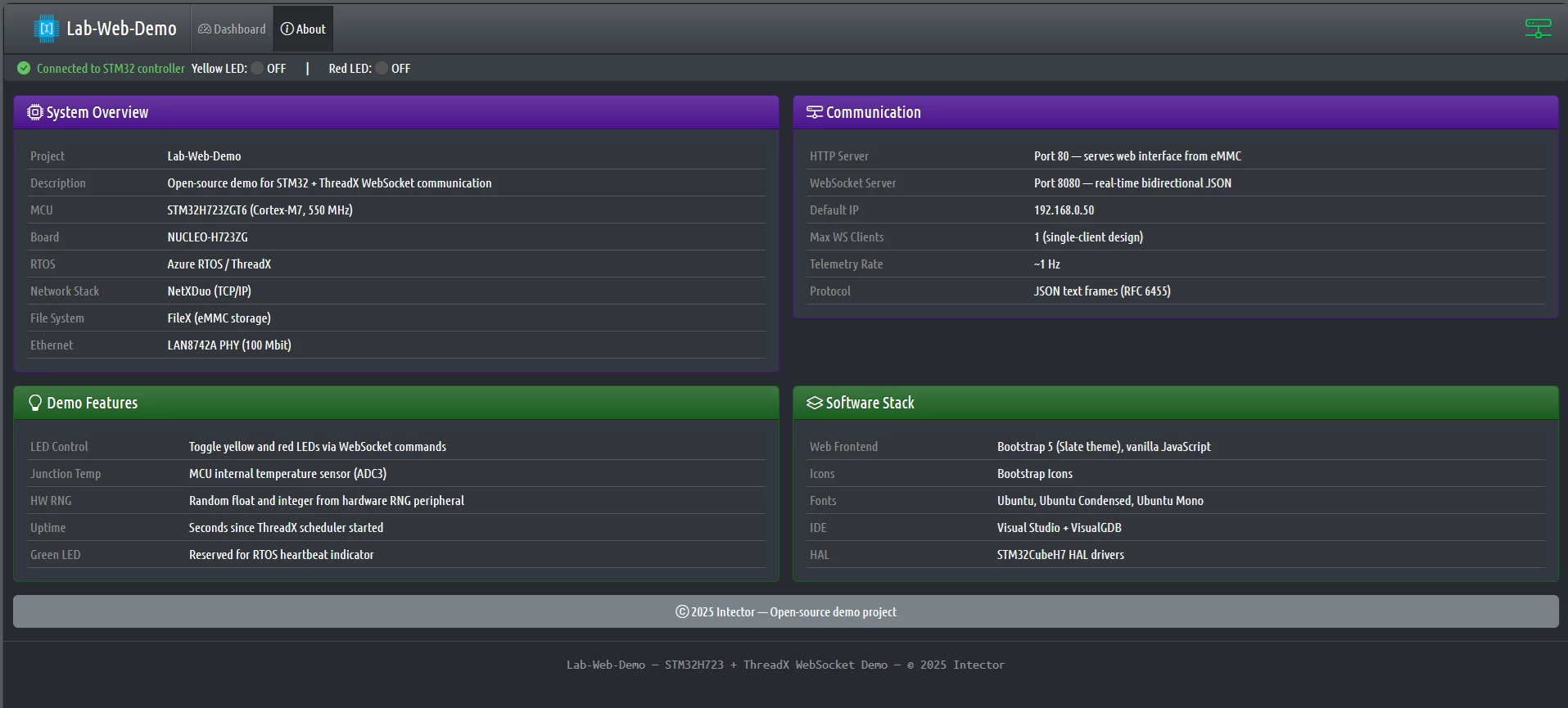

When a user opens the dashboard in a browser, the HTTP server delivers the HTML, CSS, and JavaScript from eMMC. The JavaScript immediately opens a WebSocket connection back to the board on port 8080. From that point on, the browser and the MCU are talking directly — telemetry flows from the board to the browser (configurable rate, ~1 Hz in the demo), and commands flow from the browser to the board instantly. No polling, no page refreshes.

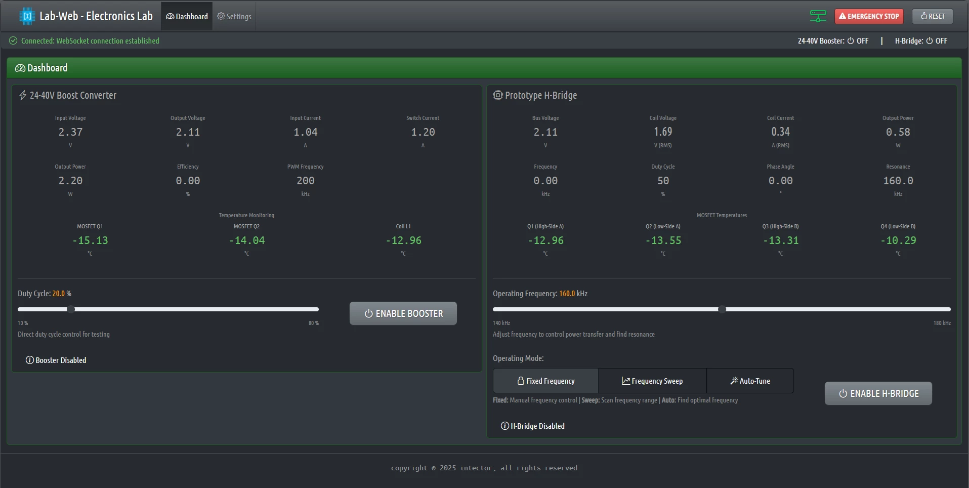

This same WebSocket architecture scales from simple demos to real hardware testing. The screenshots above show the demo project (LED control + telemetry). The screenshot below shows the same platform driving a wireless power transfer test bench — a 24-40V boost converter with a full H-bridge generating 900VAC at 160kHz for magnetic field power transfer.
The demo project in the GitHub repo is intentionally simple, so the WebSocket implementation is easy to follow. Your application replaces the LED commands and telemetry values with whatever your hardware actually does.

 status = nx_tcp_socket_receive(socket_ptr, &packet_ptr, NX_NO_WAIT);
 if (status != NX_SUCCESS) return status;
 // Parse frame header
 unsigned char opcode = data[0] & 0x0F;
 unsigned char masked = (data[1] & 0x80) != 0;
 uint64_t payload_len = data[1] & 0x7F;
 // Extended payload length (126 = 16-bit, 127 = 64-bit)
 if (payload_len == 126) {
 payload_len = (data[2] << 8) | data[3];
 header_len = 4;
 // Extract masking key (4 bytes, always present from browser)
 if (masked) {
 memcpy(mask, &data[header_len], 4);
 header_len += 4;
 // Unmask payload — XOR each byte with rotating mask
 unsigned char *payload = &data[header_len];
 for (uint32_t i = 0; i < payload_len; i++) {
 payload[i] ^= mask[i % 4];
 // Route by opcode
 if (opcode == WS_OPCODE_TEXT) {
 // JSON command — parse and handle
 WS_HandleJSONCommand(json_buffer);
 else if (opcode == WS_OPCODE_CLOSE) {
 return NX_NOT_CONNECTED;
Sending Frames — Server to Client
Sending is simpler than receiving because server-to-client frames are never masked. The WS_Server_SendJSON function builds the WebSocket frame header and appends the JSON payload:
UINT WS_Server_SendJSON(WS_Server_t *server, const char *json_string)
 uint32_t json_len = strlen(json_string);
 // Build WebSocket TEXT frame header
 frame_header[0] = WS_FIN_FLAG | WS_OPCODE_TEXT; // 0x81 — final frame, text
 if (json_len < 126) {
 frame_header[1] = (unsigned char)json_len;
 header_len = 2;
 } else if (json_len < 65536) {
 frame_header[1] = 126;
 frame_header[2] = (json_len >> 8) & 0xFF;
 frame_header[3] = json_len & 0xFF;
 header_len = 4;
 // Allocate packet, append header + JSON, send
 nx_packet_allocate(server->packet_pool, &packet_ptr, NX_TCP_PACKET, NX_NO_WAIT);
 nx_packet_data_append(packet_ptr, frame_header, header_len, ...);
 nx_packet_data_append(packet_ptr, (void *)json_string, json_len, ...);
 nx_tcp_socket_send(socket_ptr, packet_ptr, NX_NO_WAIT);
Command Handling — cJSON on the MCU
Incoming JSON commands are parsed with the lightweight cJSON library. The command dispatcher checks the type field and routes to the appropriate handler:
void WS_HandleJSONCommand(const char *json_string)
 cJSON *root = cJSON_Parse(json_string);
 cJSON *type = cJSON_GetObjectItemCaseSensitive(root, "type");
 if (strcmp(type->valuestring, "led-command") == 0) {
 handle_led_command(root);
 cJSON_Delete(root);
static void handle_led_command(cJSON *root)
 cJSON *led = cJSON_GetObjectItemCaseSensitive(root, "led");
 cJSON *state = cJSON_GetObjectItemCaseSensitive(root, "state");
 GPIO_PinState pin_state = cJSON_IsTrue(state) ? GPIO_PIN_SET : GPIO_PIN_RESET;
 if (strcmp(led->valuestring, "yellow") == 0) {
 HAL_GPIO_WritePin(LED_Yellow_GPIO_Port, LED_Yellow_Pin, pin_state);
 // ... red LED handling ...
 WS_SendLedStatus(); // confirm state back to client
The JSON message format is straightforward. Browser sends:
{"type": "led-command", "led": "yellow", "state": true}
Server responds with the current state:
{"type": "led-status", "data": {"yellowLed": true, "redLed": false}}
Telemetry — Streaming Data to the Browser
A dedicated telemetry thread reads sensor data and broadcasts it to the connected client. The update rate is configurable — set to ~1 Hz in the demo, but adjustable via TELEMETRY_UPDATE_RATE_MS in ws_telemetry.h:
void tx_telemetry_thread_entry(ULONG thread_input)
 // Wait for HTTP server to be ready (event flag synchronization)
 tx_event_flags_get(&TAGID_status_event_group, TAGID_SE_HTTP_SERVER_OK,
 TX_AND, &tmp_actual_events, TX_WAIT_FOREVER);
 while (1) {
 float junction_temp = DTS_ReadTemperature();
 // Build JSON with cJSON
 cJSON *msg = cJSON_CreateObject();
 cJSON *data = cJSON_CreateObject();
 cJSON_AddNumberToObject(data, "junctionTemp", junction_temp);
 cJSON_AddNumberToObject(data, "uptime", (double)uptime);
 // ... random float and int for demo ...
 cJSON_AddStringToObject(msg, "type", "telemetry");
 cJSON_AddItemToObject(msg, "data", data);
 char *json_string = cJSON_PrintUnformatted(msg);
 WS_Server_SendJSON(&WebSocket_Server, json_string);
 cJSON_free(json_string);
 cJSON_Delete(msg);
 tx_thread_sleep(TELEMETRY_UPDATE_TICKS); // ~1 second
The browser receives:
{"type": "telemetry", "data": {"junctionTemp": 42.0, "randomFloat": 73.21, "randomInt": 456, "uptime": 12345}}
This is where the WebSocket advantage becomes obvious. With HTTP polling, you'd be hammering the server with GET requests at whatever rate you need updates. With WebSocket, the server pushes data when it's ready — no request overhead, no wasted bandwidth, sub-millisecond latency.
The Result
The demo project gives you a self-contained reference implementation:
  • A browser-based dashboard served from eMMC over HTTP
  • Real-time LED control over WebSocket — toggle LEDs from the browser, see state confirmed instantly
  • Live telemetry streaming — MCU junction temperature, hardware RNG values, RTOS uptime, all updating in real time at a configurable rate
  • FTP access to the eMMC filesystem for updating web files remotely
  • Full RFC 6455 WebSocket implementation with handshake, frame encoding/decoding, and connection management
The web interface uses Bootstrap 5 with a dark theme, vanilla JavaScript, and connects to the WebSocket server automatically on page load. The WebSocket log panel shows every message in real time for debugging.
Replace the LED commands with your motor controller, sensor array, or power converter, and replace the telemetry values with your actual measurements. The WebSocket plumbing stays the same.
Getting Started
The complete source code is available on GitHub:
https://github.com/intector/NUCLEO-MEM
License: MIT — use it however you need.
What You Need
  • NUCLEO-H723ZG development board (or another NUCLEO-144 with OCTOSPI peripheral)
  • NUCLEO-MEM shield (provides the eMMC and PSRAM)
  • Ethernet connection (board defaults to 192.168.0.50 static IP)
  • Visual Studio + VisualGDB (primary development environment) — or adaptable to STM32CubeIDE with some effort
Key Dependencies
  • Azure RTOS / ThreadX — RTOS kernel, thread management, event flags
  • NetXDuo — TCP/IP stack, HTTP server, FTP server
  • FileX — FAT filesystem on eMMC
  • cJSON — lightweight JSON parser (included in the repo)
  • STM32CubeH7 HAL drivers
Quick Test
Once the board is running and connected to your network, open a browser to http://192.168.0.50 for the web dashboard. The WebSocket connection establishes automatically. You can also test the WebSocket directly from a browser console:
const ws = new WebSocket('ws://192.168.0.50:8080');
ws.onmessage = (e) => console.log(JSON.parse(e.data));
ws.send(JSON.stringify({type: 'led-command', led: 'yellow', state: true}));
Summary — Memory Budget
For reference, here's what the full system looks like in terms of memory allocation:
Resource Size Location
ThreadX byte pool500 KBPSRAM
FileX byte pool500 KBPSRAM
NetXDuo byte pool500 KBPSRAM
ETH packet pool~93 KBAXI SRAM
HTTP server packet pool30 KBAXI SRAM
WebSocket server packet pool20 KBAXI SRAM
FTP server packet pool100 KBPSRAM
AXI SRAM total148 KB / 317 KB (46.78%)After single-session HTTP
The three byte pools alone (1.5 MB) exceed the H723's total internal RAM. Without external PSRAM, this configuration is impossible. And even with PSRAM, the DMA-accessible packet pools still need AXI SRAM — which is why you end up carefully placing buffers across two memory regions. The single-session HTTP optimization (NX_WEB_HTTP_SERVER_SESSION_MAX = 1) is what brought AXI SRAM from a dangerous 94% down to a comfortable 47%.
I hope this helps someone struggling with the same problems. WebSocket support on STM32 is one of those things that feels like it should be straightforward but turns into a multi-week project when you realize there are no examples, no middleware, and no documentation.
The GitHub repo has the complete source code. If you have questions, suggestions, or find bugs — post them here or open an issue on GitHub. Contributions are welcome.
Thank you, and to everyone else out there:
"The secret is to keep banging the rocks together, guys."
Kai Jensen — Intector Inc.
