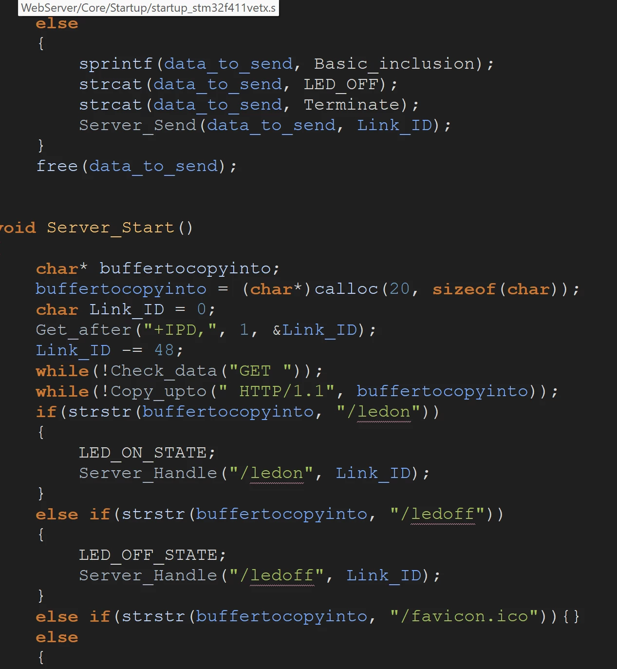

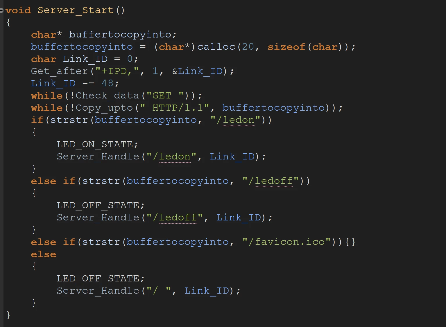

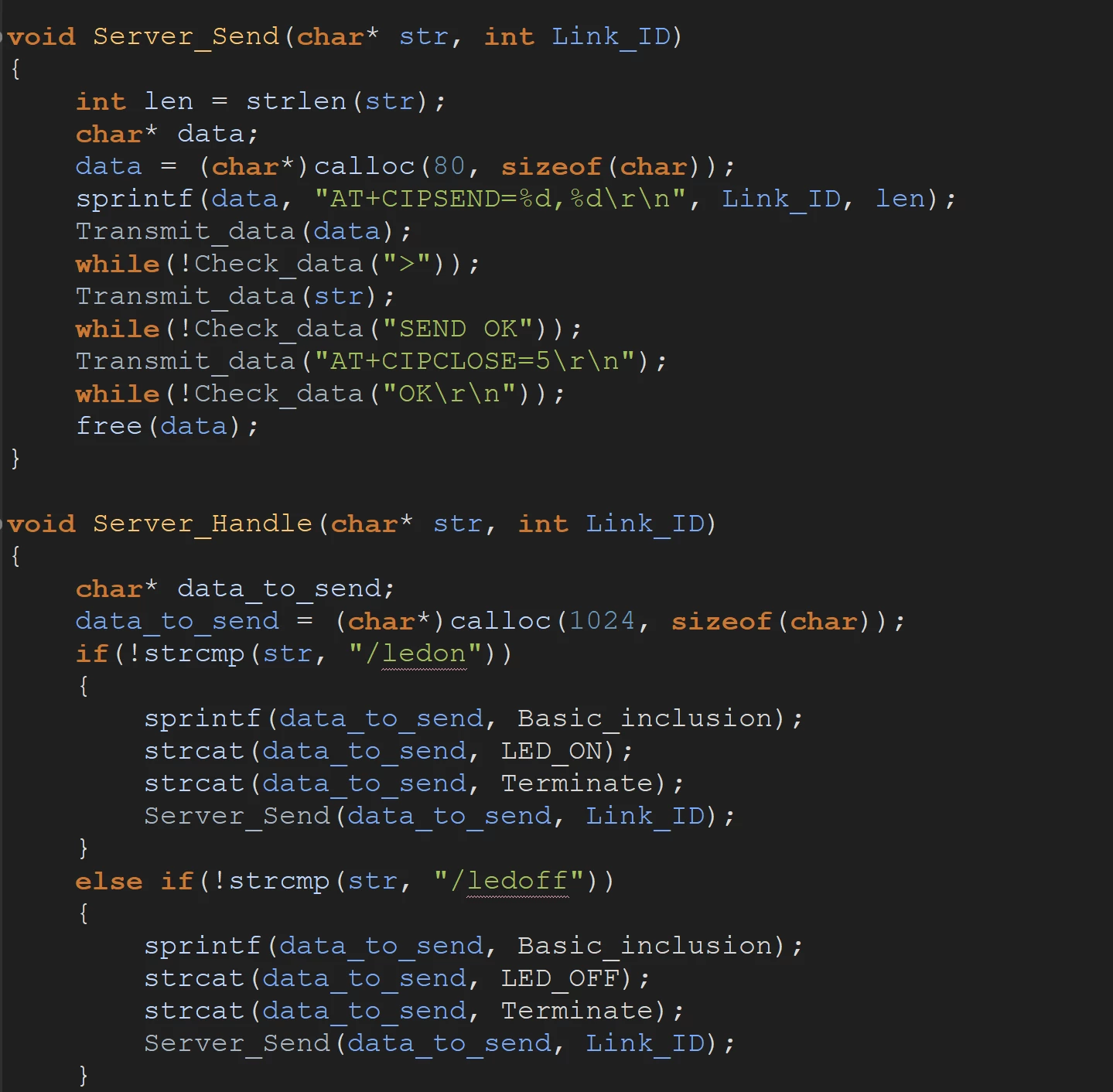

I'm having trouble using STM32 to bind to the Webserver via the AT Command command. Connecting to the Webserver is fine, but the problem is that the site only runs a few times, the AT+CIPSEND command has a problem, data sent to ESP is 1 character error causing the data response process to be ERROR. Everyone shows me how to fix it.
dnk_0-1703649881431.pngdnk_1-1703649907381.pngdnk_2-1703649927893.pngdnk_3-1703650046820.png

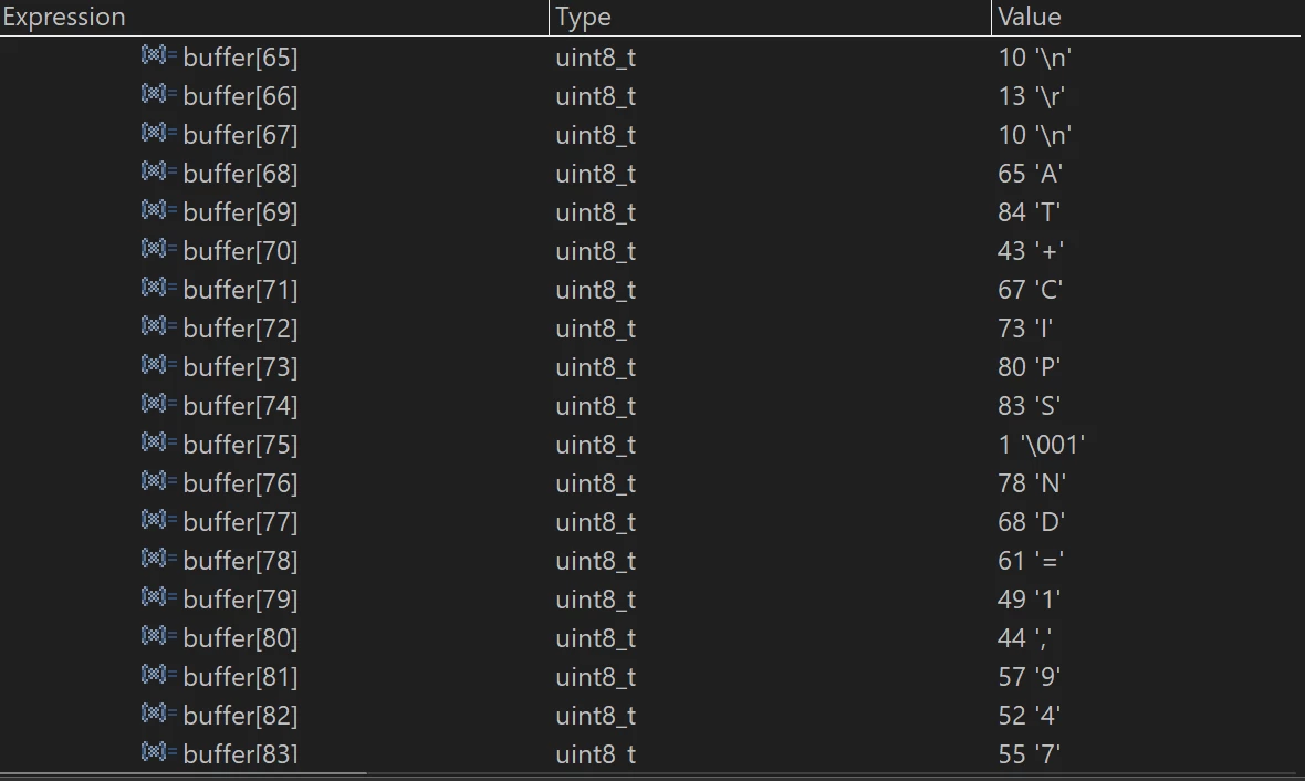

This is the problem that I encountered, the webserver run a few times, the AT+CIPSEND sending process is faulty at the letter E. I don't know what the fault is

You are allocating 80bytes for data, Check if the strlen(str) + AT+CIPSEND, \r\n exceed this limit, at the beginning of the function check this and if not, take appropriate action

before using the STM32, have you verified that you can do it manually - using a terminal?

This is what I got from the reference manual. Are you using ESP8266
<quoted from the AT_cmd for ESP 8266>
20ms interval between each packet, maximum 2048 bytes per packet. When
single packet containing "+++" is received, it returns to normal command
mode. Please wait at least 1 second before sending next AT command
For network traffic, do not expect that you will be successful always, so check for other conditions and take appropriate action..
<quoted>
If connection cannot be established or gets disconnected during send,
returns
ERROR
If data is transmitted successfully, returns
SEND OK
