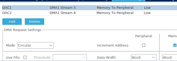

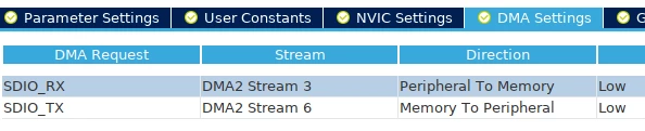

i read the ST instructions and looked in the EVAL Board example. There they used a audio jack via SPI but in want to play the file direct on DAC.
First to check if the SD Card works i write and read a file to it (works). Then I call the "play_sound" Funktion.
My problems to solve:
  1. Open the file don't work like the text file -> What's the problem
  2. How can I transfer the value of buffer one and two to the DAC. May be via DMA

Okay File is loaded step by step to DAC but no proper sound, may the speed is wrong?
CPU Frq = 72MHz
