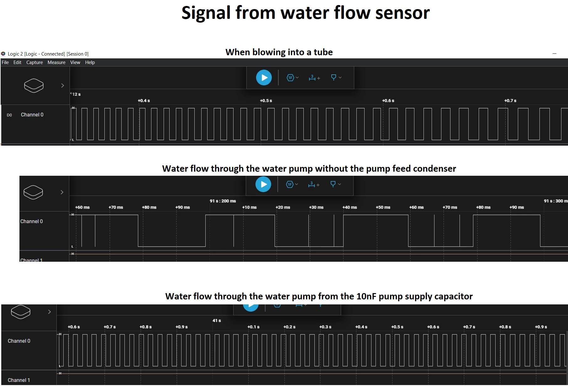

Hi, I have a problem with the flow meter
Generally the flow meter catches air, which makes me unable to take accurate measurements.
Correction, maybe not so much that the flow meter is catching air, because there is no signal on the logic state analyser during air. The signal is only there when water is actually flowing.

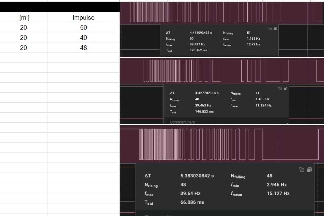

I am attaching a screenshot where I have set the pump to take a measured 20ml three times, and let's say this would agree with the measurements I used to take "dry", i.e. without a water pump just pouring into the sensor And then it agreed that:
ML = totalImpulses * 0.48 ;
I got rid of the pins that the water pump was giving by adding a 10nF capacitor between the pump supply

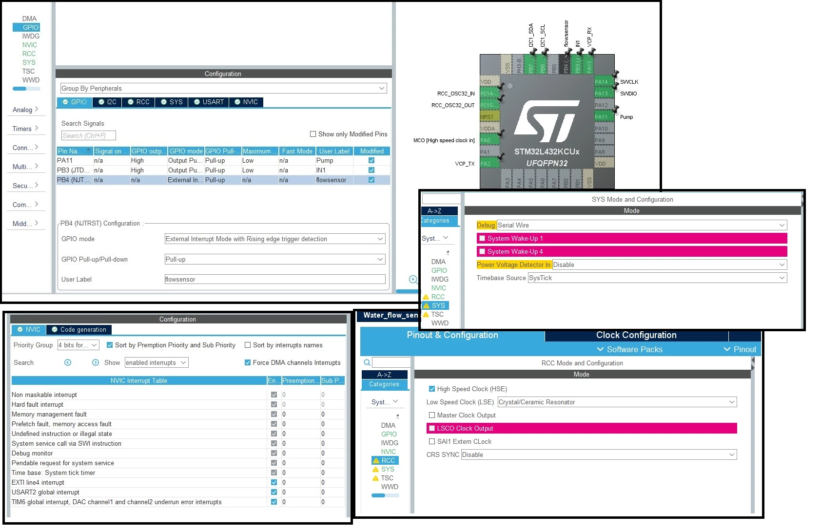

Below I attach the code I uploaded to the STM32L432KCU6 nucleo
And the stm32CUBEide settings

Does anyone know what I am doing wrong? How do I correctly count the liquid already flowed?

These kinds of sensor just give you a count whether you blow air into it or water flows through it. so volume is number of count/second X area of the tube. It is assumed that the tube is full. If you need to measure very accurate, better to take the weight of the liquid using sensitive balance.
