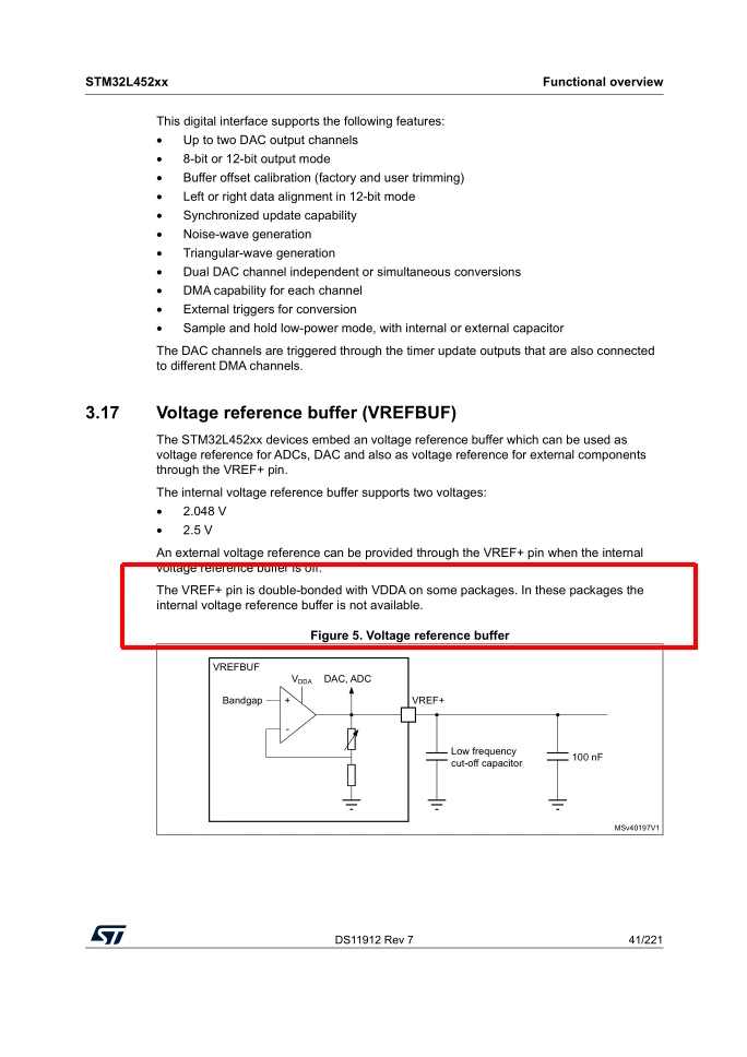

> The VREF+ pin is free to float (see schematic below)
As I've said above, this is the small package, where it's internally connected to VDDA. And you can't use analog functions like DAC without connecting external power source to VDDA.
Consequently, you cannot use the internal VREFBUF in this package.

> am trying to set the ADC reference voltage programmatically back and forth between the internal VREF (set to 2.5V) and the external 3V3 power rail.
You can't change that *programmatically*.
ADC/DAC reference is *always* the physical VREF+ pin. (in smaller packages bonded internally to VDDA). What "using internal VREF" in Cube in fact does is, that it switches on the internal reference and connects it to this pin. If you want to actually switch between external and internal VREF, you need to remove the external voltage from VREF+ pin, and you have to have a prescribed capacitance connected to it.
Note, that in smaller packages, VREF+ is internally bonded to VDDA, so you cannot disconnect it thus you can't use the internal VREF in those packages.

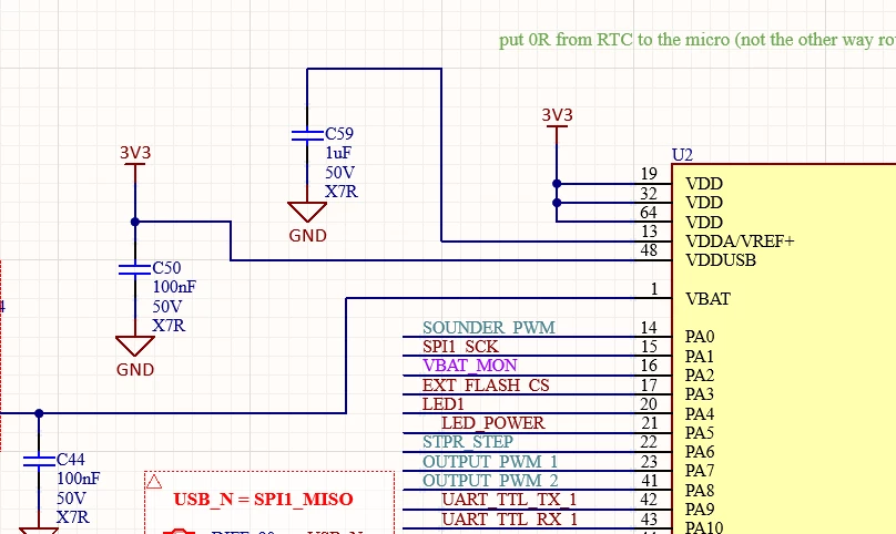

The VREF+ pin is free to float (see schematic below), but the DAC reading voltage doesn't seem to change when I change the VREF from VDD to 2.5V as shown in the instructions above.
Are there other instructions and/or sequence to do that?
Thank you
waclawek.jan
waclawek.janBest answer
Aug 12, 2024 12:49 PM UTC
