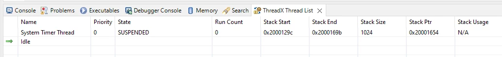

Ok. So I re-installed CubeIDE in its default location (C:\ST), re-downloaded the example and appropriate software packs, built the project, then debugged the project. Examined the Device Manager to see COM8 at 115200 bps being used by STLink Virtual Com Port. Opened my Hercules terminal on that port. Still no activity.
Target Nucleo-NUCLEO-F429ZI
USART3 connected to STLink internally.
USART3 configured by CubeIDE to 115200,8,none,1
Hercules set to COM8 115200,8,none,1
FYI, the example builds OK and runs. But is stuck in the __tx_ts_wait: loop. So it looks like the processor is running but no interrupts are firing, So no TCP IP traffic is flowing. And there is only one thread showing in the ThreadX List (see below).
I am questioning whether the Example structure is correct. Can someone verify that this specific example runs as it is supposed to?
Thanks,
MikeH

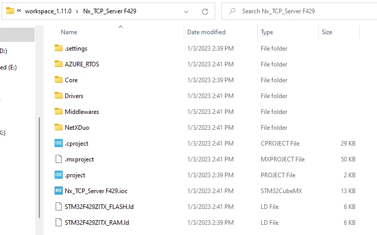

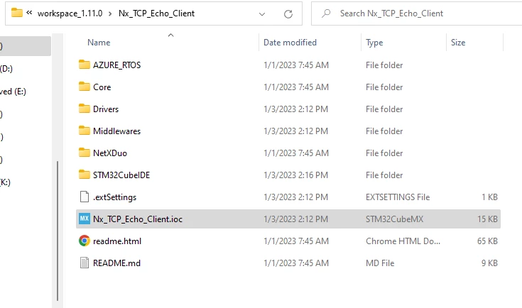

MHoop.1
MHoop.1Author
Senior
Jan 3, 2023 7:54 PM UTC
This appears to be a problem with the project structure generated by CubeIDE rather than with VCOM.
The projects that were not communicating with VCOM were actually not running correctly. The code generated by CubeIDE was incomplete (I think). Therefore the only thing that was running was the MCU and its basic functions. The actual Azure code was not running.
I WAS able to get one project to run, and it DID communicate with VCOM port. Here is the example file structure of the working project.
0693W00000Y7JxWQAV.pngBut below is a typical file structure (generated by CubeIDE). This project does NOT work, nor does it communicate with the VCOM port.
0693W00000Y7JyZQAV.pngNotice that the working file structure has a STM32CubeIDE folder, but the non-working project does not.
Can someone point out what I am doing wrong?
Thanks,
MikeH
Pavel A.
Jan 4, 2023 12:06 AM UTC
It's hard to tell what is wrong in the generated project without debugging. But [more often than not] cube-generated projects do not work as is, need some manual adjustment.
So it is recommended to always start from a ready example rather than generate from scratch.
