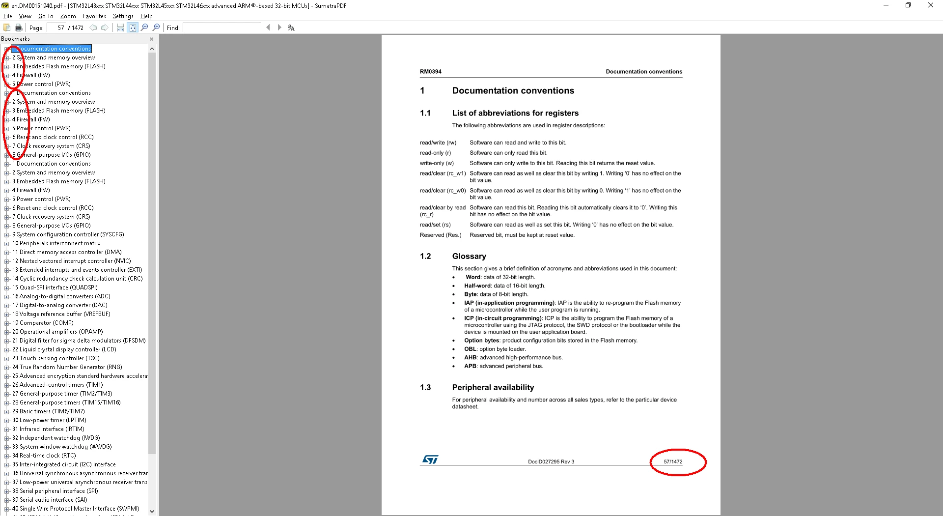

OT: I went for the
http://www.st.com/content/ccc/resource/technical/document/reference_manual/group0/b0/ac/3e/8f/6d/21/47/af/DM00151940/files/DM00151940.pdf/jcr:content/translations/en.DM00151940.pdf
(I believe this is the newer, better, shinier) to find out this:0690X00000607z5QAA.png
