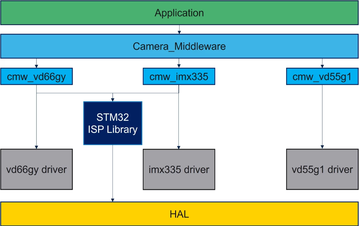

Is there any code for driving vd55g1 in STM32N6570-DK? It is stated in STMicroelectronics/stm32-mw-camera  that vd55g1 is supported, but I have not found the demo for its use. Could you please provide the demo?

The VD55G1, and all other BrightSense image sensors, can be used with the following evaluation software on : https://www.st.com/en/embedded-software/stsw-img501.html
Additionally, you can refer to the user manual UM3224, which provides detailed guidance on how to integrate and configure the VD55G1 sensor.
For the STM32N6570-DK board, you may want to explore the DCMIPP application available on GitHub. This application supports the IMX335 camera sensor component, and you can use it as a reference example to configure your VD55G1 sensor.
