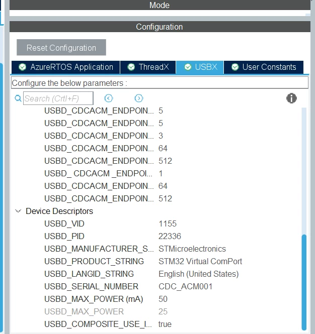

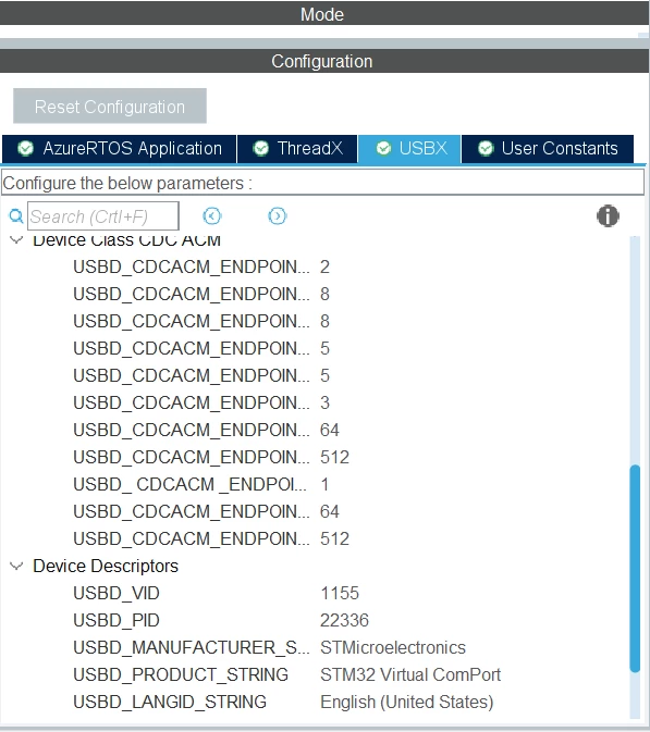

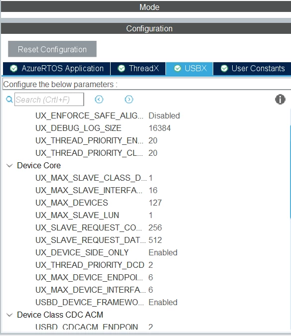

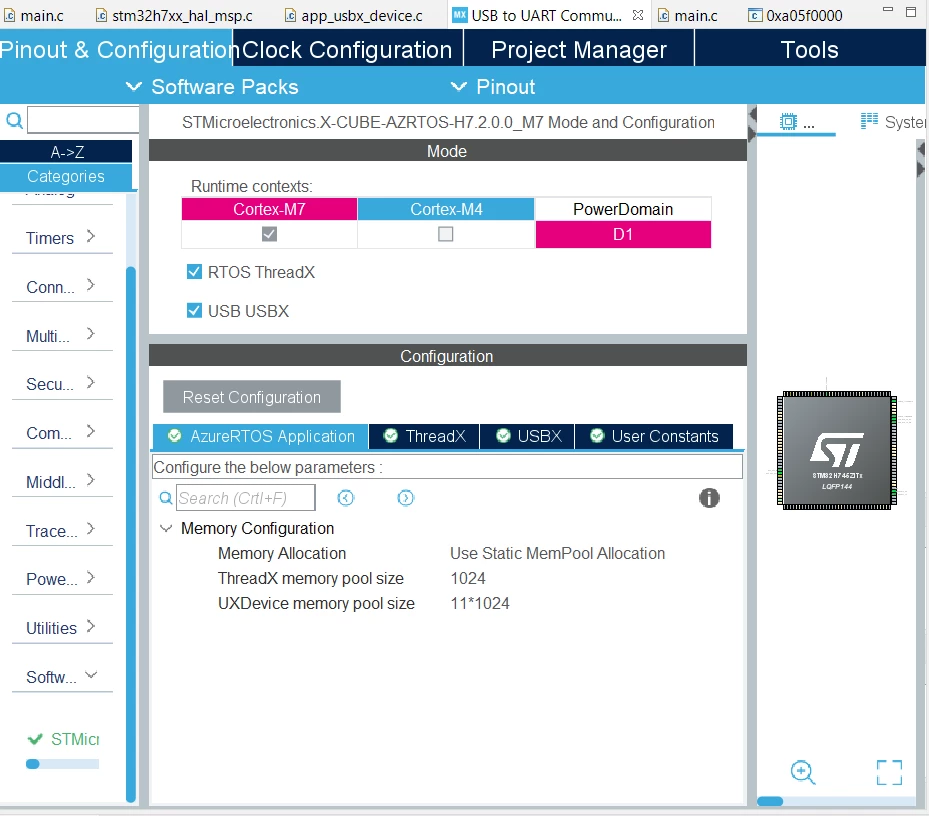

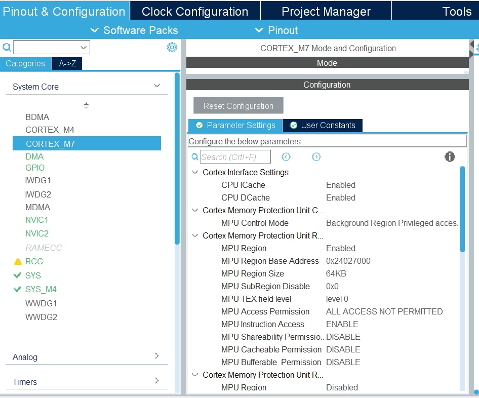

Ux_Device_CDC_ACM Usb port not recognize in Device manager
I am working on Nucleo-h745ziq board. The example provide in cubemx of Ux_Device_CDC_ACM accordingly I create the example for Nucleo-h745ziq board. The changes I make that instead of HS I select Fs mode because board support the FS mode and disable the MPU protection because it gives problem for CM4 core. When I connect two usb only STLINK Port recognize user USB port is not get updated. I share the setup things,

0693W00000GXtPkQAL.png0693W00000GXtPVQA1.png0693W00000GXtP6QAL.png0693W00000GXtOhQAL.png0693W00000GXtOcQAL.pngWhy the port is not get updated the Device driver? Can you help me. Because I am newly work on Azure Rtos I don't have much knowledge of it.
