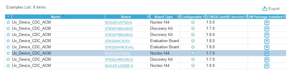

Ux_Device_CDC_ACM example project for NUCLEO-H723ZG is not available in CubeIDE
I can see the folder in the X-CUBE-AZRTOS-H7 2.1.0 repository but it is not available in the STM32CubeIDE Example selector.
Can I fix CubeIDE or manually import the project?

Hi @Ade​ ,
Ux_Device_CDC_ACM example project for NUCLEO-H723ZG is available in CubeIDE as shown in the attached figure. So, you can resolve this problem by downloading the latest version of CubeIDE 1.9.0 and/or by updating the example package.

Just needed to update, Thanks!
