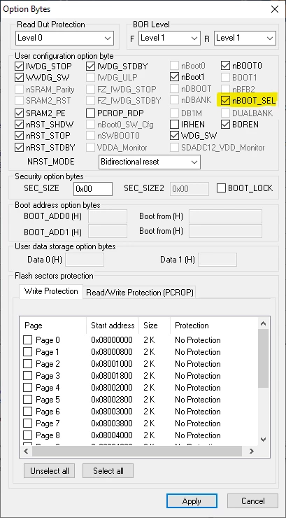

I would guess, You had empty memory, when You tried first. So Bootloader was activated because of empty memory and not BOOT pin state. Try to connect with ST-Link via STM32CubeProgrammer and check option bytes. ST default production value for nBOOT_SEL is 1, which means it is by default ignoring BOOT0 pin and takes signal from nBOOT0 bit in Option bytes. For more information about Option bytes please check reference manual, section 3.4. FLASH option bytes.
If You will change nBOOT_SEL value to 0, You can then use BOOT0 pin again.
I hope it is clear now. Have a nice day.

I can confirm this.
Using the ST-LINK utility, I connected the target with the previously described "connect under reset" method. Then I opened the dialog Target -> Option bytes and found that nBOOT_SEL was checked, meaning that the state of the BOOT0 pin is ignored and the activation of the bootloader is determined by the state of the nBOOT0 bit (3 positions above nBOOT_SEL in the picture), which is checked, meaning the bootloader will not be activated.
Thank you all for the help.
