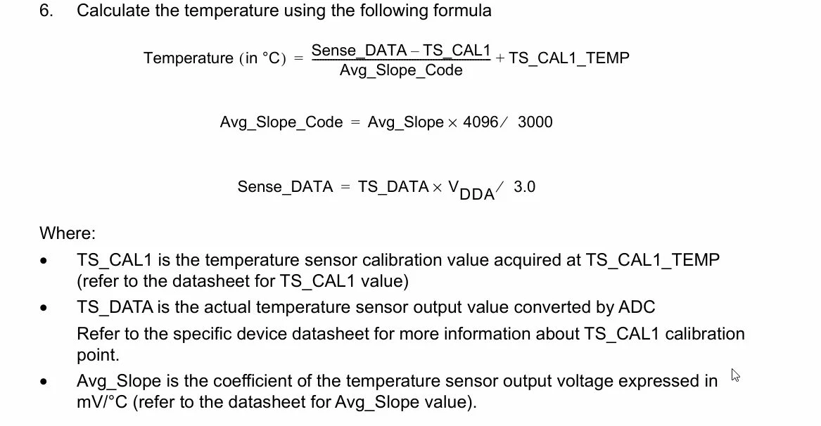

I'm using the internal temp sensor on a C011 chip *actually the STM32C0116 dev board) and trying to  get an approximate reading in C, using __LL_ADC_CALC_TEMPERATURE_TYP_PARAMS macro.
I understand that this won't be very accurate, but it seems that when I use the T_CAL1 value stored in ROM the result actually gets significantly worse. Here is my code:
#define VDDA_APPLI ((uint32_t) 3300)
#define TEMPSENSOR_TYP_CAL1_V (( int32_t) 760)
#define TEMPSENSOR_TYP_AVGSLOPE (( int32_t) 2530)
#define TEMPSENSOR_CAL_VREF ((uint32_t) 3000)
int32_t get_last_temp_reading(void)
	uint16_t t_cal1 = *TEMPSENSOR_CAL1_ADDR;
 return (int32_t)__LL_ADC_CALC_TEMPERATURE_TYP_PARAMS(TEMPSENSOR_TYP_AVGSLOPE,
 //TEMPSENSOR_TYP_CAL1_V,
		 t_cal1,
 TEMPSENSOR_CAL1_TEMP,
 VDDA_APPLI,
		 raw_value,
 LL_ADC_RESOLUTION_12B);
My raw_value is 787. When I use the typical datasheet value of 760, I get a result of -20. If I use t_cal1 (which has a value of 1048) I get -134
What is going on? OK, I don't expect much accuracy, but using the internal cal value should at least make things better not worse?

What temperature are you expecting to see?
The t_cal1 value is an ADC reading, not the value in mV. Multiply by 3000, the divide by 4096 to get the voltage.

danmcbAuthor
Apr 15, 2025 12:14 PM UTC
using the datasheet and trying to do it manually (screenshot below):
Avg Slope Code = 2.53 x 4096/3000 = 3.45
sense data = 787 x 3.3 / 3 = 866
TS_CAL_1 = 1048
Temp = ((866 - 1048) / 3.45) + 30 = -23
I am just putting the numbers into the equation, exactly as described, so something is incomplete or unclear here.
RobK1
Apr 15, 2025 12:20 PM UTC
Well, the 787 you quote as raw value does indeed correspond to -20°C, according to the calculations given in the manual. Using the t_cal1 value it's -22.8
I would expect to see an ADC count of around 1030 at 25°C
  • Are you meeting the required minimum sampling time of 5µs?
  • Are you meeting the required start-up times given in the datasheet?
Apr 15, 2025 1:19 PM UTC
In addition to these:
  • Are you calibrating the ADC on startup, before it is used?
danmcbAuthorBest answer
Apr 15, 2025 2:05 PM UTC
indeed, I think sampling time was the issue. I went back into CubdeMX, slowed down the ARC clock and the sampling setting to about 10us, and now I get results of about 70 degrees, which are believable.
I still cannot make sense of the supplied macro in the library, but if I do it myself, I get these numbers now.
