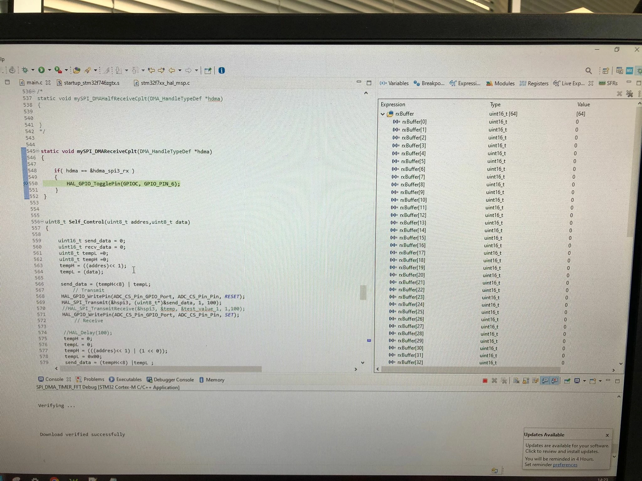

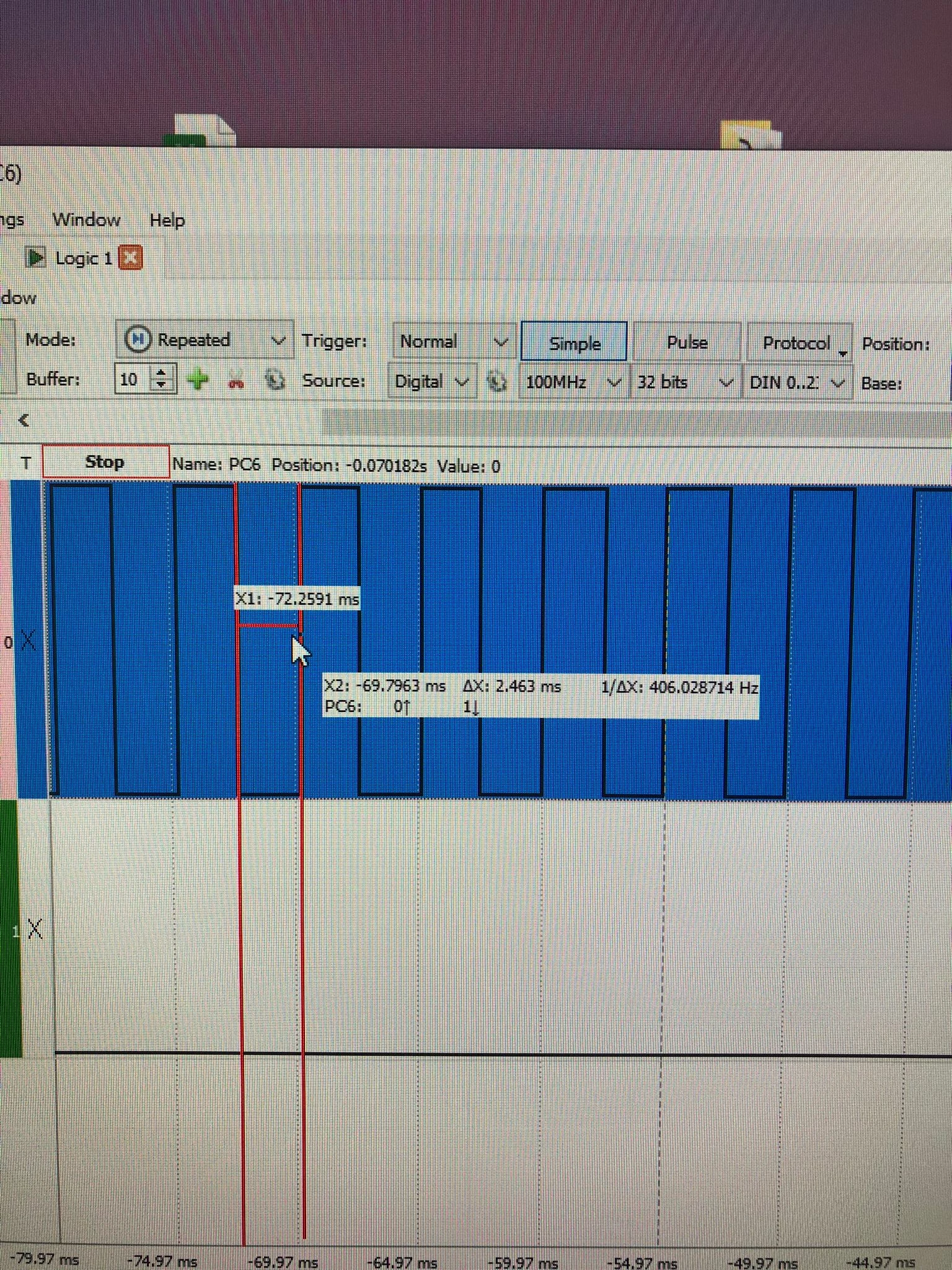

I want to share my related code and photo here. The program runs on an STM32F746 Nucleo Board.  It uses timer 2 to trigger DMA1 stream 0 causing fixed-length transmission of data via SPI 1 to an external ADC without interrupts on the transmission side. Timer 2 confüguration is settled at 25600Hz this is used as a sample rate. Therefore data must be received with SPI3 every 25600Hz. I created a test pin to understand that the sampling process is finished. The sample size is 64. The complete time is  64 x 1/25600 = 400Hz. I can see this period with diligent oscilloscope but the received data is empty. Can you show me where I'm doing wrong?

Oct 3, 2023 2:06 PM UTC
Since mySPI_DMAReceiveCplt is being called, something is working right.
How do you know 0 isn't the correct data in this case? Initialize it to something unique (perhaps a ramp, 0, 1, 2, 3, etc.) and see if it gets changed. (Even if 0 isn't the expected data, it could still be due to a pin misconfigured or disconnected or otherwise.)
Could also define rxBuffer as volatile, but I doubt that's it.
armcoAuthor
Oct 3, 2023 2:28 PM UTC
I defined buffer as volatile but there is no change. I can see debugging mode.

// This case is triggered the dma , it is correct because we can see the image that 405Hz toggle pin.

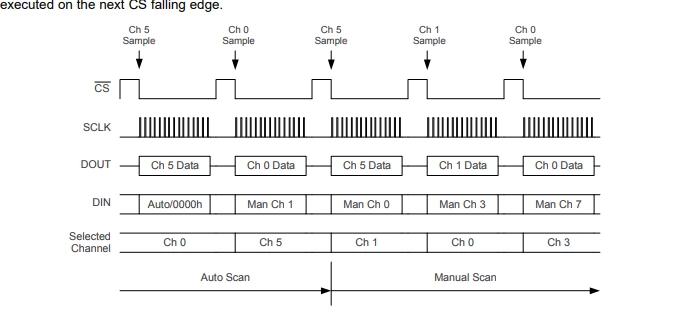

armcoAuthor
Oct 4, 2023 11:53 AM UTC
The error comes from triggering the SPI NSS pin.
First, I performed Hardware output Nss and saw that it did not write or read the register return value was 0. After Hardware I canceled NSS and turned it on and off with software. I wrote to the registers and read the correct data, but I could not read adc value. The problem right now is that I need to turn the CS pin on and off while receiving data via dma.
waclawek.jan
Oct 4, 2023 12:13 PM UTC
How? Show some timing diagram.

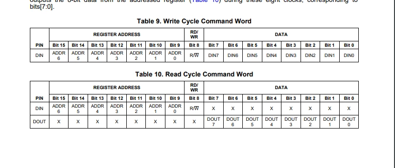

When i  use manual CS (SSM =1, software slave management)  i can read data that I wrote the register but i use hardware use it doesn't work. I make debugging i see received data "0" because of time out.
I don't understand why cs not work with Hardware NSS output enabled. I will look into this issue.

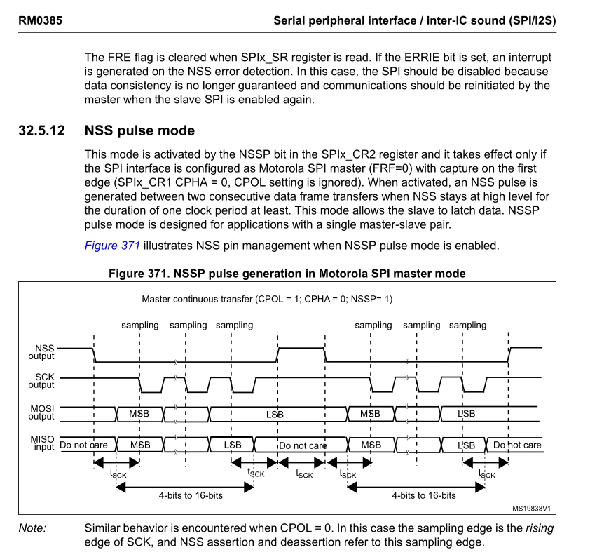

Oct 4, 2023 3:04 PM UTC
Check out NSS pulse mode:
Note that CPHA must be 0. Check with the slave's datasheet if this is viable.
I don't use Cube/CubeMX so don't know how to click this in CubeMX or what Cube/HAL incantations lead to this being properly used.
