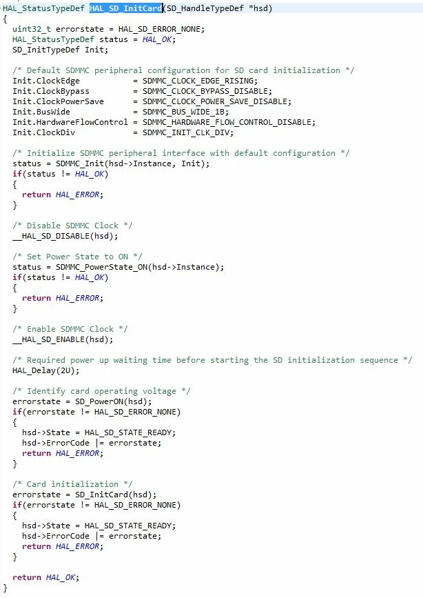

Hi there,
I'm trying to get the SD 1-bit  interface working on my STM32L476. I generated the code with the STM32CudeMX.
So that's my problem:

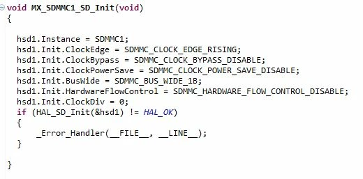

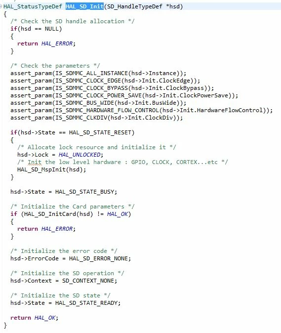

The init function ''MX_SDMMC1_SD_Init'' [1] stucks in a loop. So, I used the debugger to find where exactly the error occurs. You can see the code snippets below. function[1] calls function[2] , function[2] calls function[3] and so on.

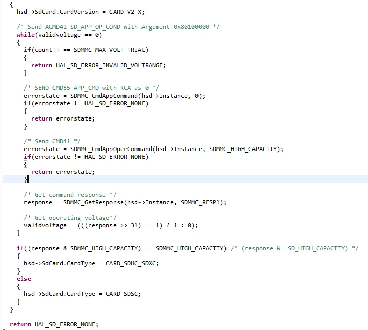

In function [4], the call of SDMMC_CmdAppOperCommand(..)  generates the error ''SDMMC_ERROR_CMD_CRC_FAIL''.
Any suggestions on how to solve or debug this issue any further?I have a digital analyzer, but it does not support SD protocol. The D0 line stucks at 0 V. The sd card comes fat32 formatted.
I'm new to this protocol and did not find any good documentation / application notes / getting started sheets. So, something like that would be very helpful too.
Thanks in advance!
SNIPPETS

I have the exact same problem! Have you been able to find a solution?

Hi Fabian, I might be able to help get past this point. Currently my power_on passes and I can retrieve parameters from the sdcard but my f_mount,etc still fails. DO you have pull-up resistors on your lines to 3.3V?
