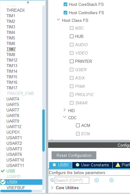

Using Prolific-USBX Driver Without ThreadX Core
Is it possible to use the Prolific USBX library without ThreadX Core? In STM32CubeMX, when I deselect ThreadX Core, the Prolific USBX option is no longer available. However, I can generate the USBX CDC-ACM library without enabling ThreadX.
Could you provide some information on this? I couldn’t find any relevant details in my searches.
I am using STM32H563.
Thanks!
Mohamed_AYEDBest answer

Hio @acbingol , USB host profilic class in standalone mode (without rtos) is not supported in USBX 6.4.2

Hi @acbingol
Unfortunately, this is not implemented using CubeMX and we don't provide examples for FTDI application.
