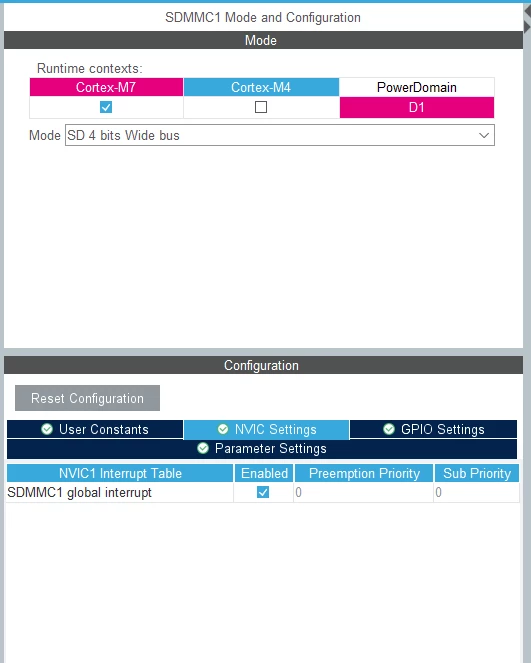

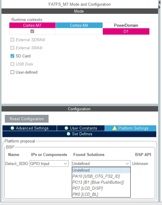

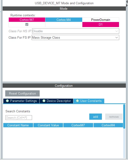

I'm trying to use an STM32H745I-DISCO to log values from a sensor, append the values on a .txt file on the onboard eMMC, and have the text file accessible when plugging in the board over usb (so using the board as a usb device). In other words, I want to use the internal eMMC as an SD card available over mass storeage. This all should happen using only the H7 core. I have screenshots of all the cubemx configurations attached. I'm running the code from this tutorial https://www.youtube.com/watch?v=I9KDN1o6924 to get the FatFS filesystem working. It errors out at a call to SD_PowerOn. I think the issue is in the FATFs configuration in CubeMX under platform settings, but none of the options match the tutorial. I looked at the FatFs_Shared_Device example, but it looks like a totally different middleware.

SD Card and eMMC are sufficiently different in their behaviour and expectations that they are not interchangeable.
My approach here would be to take an USB MSC Device example (H747I-DISCO), and merge in the eMMC support, replacing the SD Card usage.
