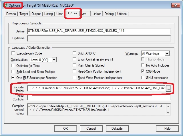

Hi everyone,
I tried to copy the folder STM32Cube/cubeF4... so when i change something it doesn’t make any changes in the original folder, so then I compiled , the error was in main.c (#include “main.h�?) (no such file or directory).
thanks

Should be under the project options tabs for whatever tools you are using, perhaps review docs related to "Include Paths", it is a standard C compiler concept.

Jul 8, 2019 7:01 PM UTC
So either you haven't copied all files the project consists of, or you don't have your Include Paths set up correctly.
Paths can be relative in certain tools, so a directory copy needs to maintain the same depth.
For Keil you can simple duplicate/clone a would directory, and sub-directories, at the same level
ie
...\STM32Cube\Repository\STM32Cube_FW_F4_V1.24.1\Projects\STM32F413H-Discovery\Examples\GPIO\GPIO_EXTI
to
...\STM32Cube\Repository\STM32Cube_FW_F4_V1.24.1\Projects\STM32F413H-Discovery\Examples\GPIO\GPIO_******_WINGNUT
