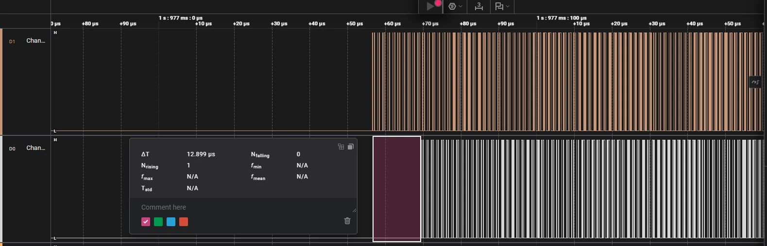

I managed to configure the SAIs, send and monitor the output data and it is working well but I noticed (an obvious I guess) latency between the payloads of the signals, between the 2 calls of the HAL_SAI_Transmit_DMA function, as you can see on the screenshot (12 us approximately).
I would like to reduce this latency under 1 microsecond if possible. During my experimentations I noticed it was possible to set one SAI as master and the other one as its slave and only call HAL_SAI_Transmit_DMA once, but haven’t managed to make it work for now. Is it really possible ? I am looking for a code example to be sure to setup the SAIs properly.

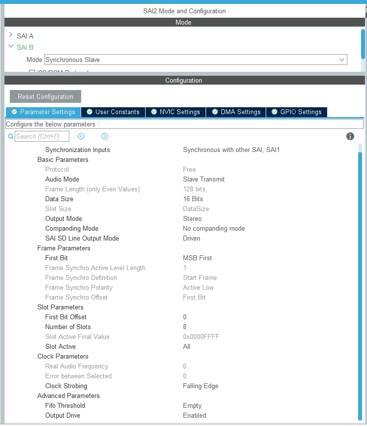

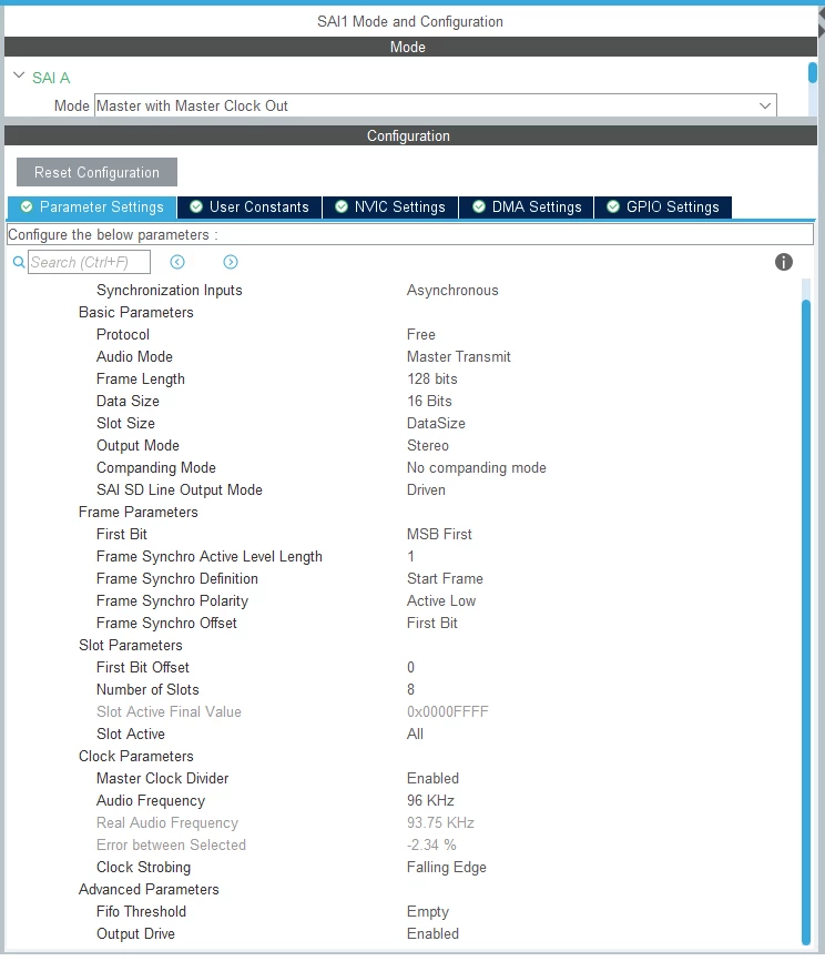

After some testing I managed to send data with SAI1A as master and SAI1B as slave so the slave is synchronized with the master. The slave waits for the master signal to send the data so the delay disappears.
However, I would like to do the same with 2 different SAI (SAI1A and SAI2B), not 2 from the same block. I used the exact same config and set the sync input to synchronous with sai1 but I do not see any data when monitoring SD pin.
I am trying to send the output on all dacs at the exact same time, timing is really important because of phase-shift on the data.
Are your SAIs configured as Masters ? And if so, how can you have no delay between the different HAL_SAI_Transmit_DMA calls if the SAIs are not synchronized together ?
You can see attached the SAI1A and SAI2B configs.

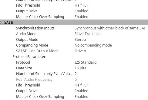

pti_juAuthor
Jul 16, 2026 15:30 UTC
In your example I see the synchronization is with other block of the same SAI. This one is working fine indeed, the issue is when the sync is with another SAI not from the same block. (SAI1A with SAI2B)
AScha.3

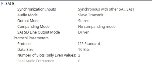

Jul 16, 2026 15:33 UTC
right, here the “other”: SAI 2
AScha.3
Jul 16, 2026 16:05 UTC
But here i see : data size 8 bit, master is 16b. Is this what you want ? Because how it fits to the 16b frame from master ?
(I have I2S format, there is no problem having 32b and 16b frames, as i use for my dacs.)
And i use IDE v 1.18.1 , or 1.19 . and you ?
pti_juAuthor
Jul 17, 2026 07:33 UTC
No that is not what I want, I would like both master and slave to be Data Size = 16 bits, but here I somehow cannot change the frame length of the slave if it is set as synchronous.
So I cannot change the data size either because it cannot be bigger than the Frame Size.
I am using CubeIDE version 2.1.1
pti_juAuthor
Jul 17, 2026 07:53 UTC
Ok I forced the Frame length and data size values to what I wanted despite CubeMx not letting me to, and found the answer to my problem.
I forgot to tick the external synchro output on SAI1A and now it’s working for SAI1A master and SAI2B slave.
