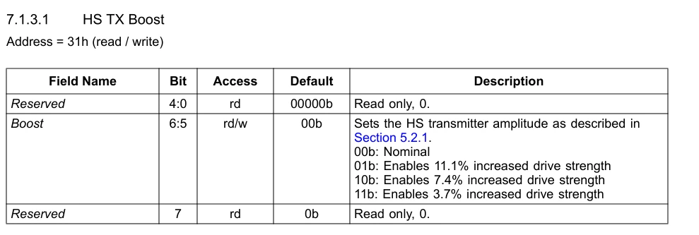

Use USB3320 as HS ext. phy. for STM32H753. Need boost drive strength
I'm use USB3320 with STM32H753.
And I want to control USB3320 with ULPI operation to boost drive strength.
Is there any method? I can't found solution both in HAL API and register.
Thanks.

I know that there is a STM32F769I-DISCO example code that controls hidden secret register to access USB PHY through ULPI.
https://github.com/STMicroelectronics/STM32CubeF7/blob/master/Projects/STM32F769I-Discovery/Examples/PWR/PWR_CurrentConsumption/Src/stm32f7xx_lp_modes.c
I can't find similar example for H7, but it would worth to try.
Good luck.
