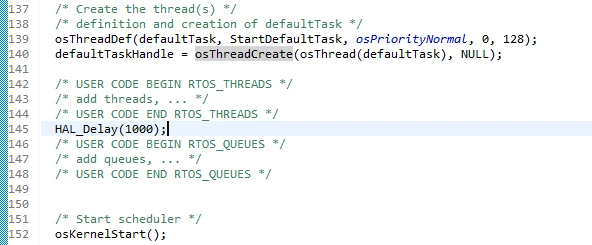

Hi all,
I am working with the Nucleo-L476RG board.
I generated a project with CubeMx and enabling FreeRTOS.
At this point the project is running fine.
I debug the project and all is working.
I put a breack point inside the "SysTick_Handler" and this hadler is always launching.
Now, in main function, I add "HAL_Delay(1000)" after creation of the default task with "osThreadCreate" function:
When I debug this code, the "SysTick_Handler" is never launching.
And the code hangs in the "HAL_Delay" function where "HAL_GetTick()" function returns always 0.

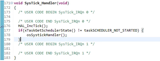

I read at https://community.st.com/s/question/0D50X00009XkYFaSAN/freertos-stm32-tick
that If Iwant to use HAL_Delay() before vTaskStartScheduler (osKernelStart), I need to check scheduler state before call xPortSysTickHandler:
I add this check in "SysTick_Handler":
BUT the problem persists because the "SysTick_Handler" was never launched.

Sirac
Apr 9, 2019 12:26 PM UTC
A ok. For me it works but for you, firstly, remove this:
" if (xTaskGetSchedulerState() != taskSCHEDULER_NOT_STARTED)"
beacause it's already done in the osSystickHandler.
The HAL tick and the Os tick are completly independant. Normally, you have to use the TIM 1 as timer for the HAL tick. Is it done ?

Rob.Riggs
Senior
Mar 15, 2023 9:59 PM UTC
I just ran into this issue and I thought I would leave an answer which explains what is happening for anyone else experiencing this issue and how to avoid it. FreeRTOS raises the NVIC base priority as soon as any FreeRTOS function (such as osThreadCreate) is called. This disables most interrupts, including SysTick. It is only after the scheduler starts that the the NVIC priority is lowered to normal, re-enabling interrupts.
It is best to do all of the FreeRTOS/CMSIS-OS initialization in one block, doing nothing else within that block. Everything else should be done either before the first FreeRTOS call or within a FreeRTOS thread.
It would be helpful if the STM32CubeIDE templates included this information in a comment in main().
Reference: https://www.freertos.org/FreeRTOS_Support_Forum_Archive/December_2012/freertos_Using_interrupts_before_kernel_starts_6447124.html

Rob.Riggs
Senior
Jul 30, 2024 4:05 PM UTC
@Yassine1 I don't think there is anything to overcome -- one just needs to be aware of the issue and write one's code accordingly.
