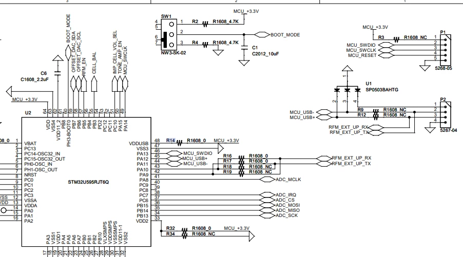

  • custom board, The USB D+ and D− lines are connected directly from the MCU to the USB Type-B connector, with no intermediate components.
  • There is no pull-up resistor on the D+ line, as I understand that the MCU provides the pull-up internally
  • As far as I know, the stm32u595 supports USB High-Speed using its internal PHY.

I implemented a simple CDC ACM echo function to verify USB communication.
  • In Full-Speed (FS) mode, the echo function works correctly. The PC recognizes the device, and both transmit and receive operate normally.
  • In High-Speed (HS) mode, however, the PC does not recognize the USB device at all (it reports an unknown or unrecognized USB device), so communication cannot be established.
What could I be missing, or what configuration should I check?

While preparing the schematic to attach, I noticed an issue with the circuit. The USB signals were connected to pins 2 and 3 of connector P2, but the connected diode had not been removed.
Once I removed the diode, the PC recognized the USB properly, and the communication was carried out smoothly. It was my mistake, and I truly appreciate your support and attention to this matter

can you share your .ioc file or some schematics
BR
