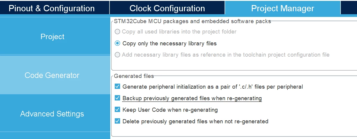

But every time I generate code with CubeMX (I'm using STM32CubeIDE), this change gets overwritten because it's not in a USER CODE section.  I've read all the docs I can find but I can't find a technique for doing this.

In terms of integrating this with CubeMX, unfortunately, there doesn't seem to be a direct way to do this. Under project manager window under code generator, you can keep the original files, by checking 'Backup previously generated files when re-generating'
As for USBX, you would need to define your class and its associated functions, and then register it. This would involve using the ux_device_stack_class_register() function.

Thanks for confirming that CubeMX can't do this.  I have come up with a temporary work-around by modifying the .FTL files with my project-specific code (yes, I know that won't work once I have more than one vendor-specific project).
The way I see it, your suggestion of "Backup previously generated files" would still mean I need to manually copy the backed-up files back over the source files, right?
Thanks for the tips about registering the class - I've seen the DPUMP source and I have a rough idea of the steps I need to take.
Graham
Feb 27, 2024 8:20 AM UTC
Hi @grahamm
This feature allows to save all source files and header with .bak extension before regenerating and you will not need to copy files anymore.
It is worthy to give it a try.
