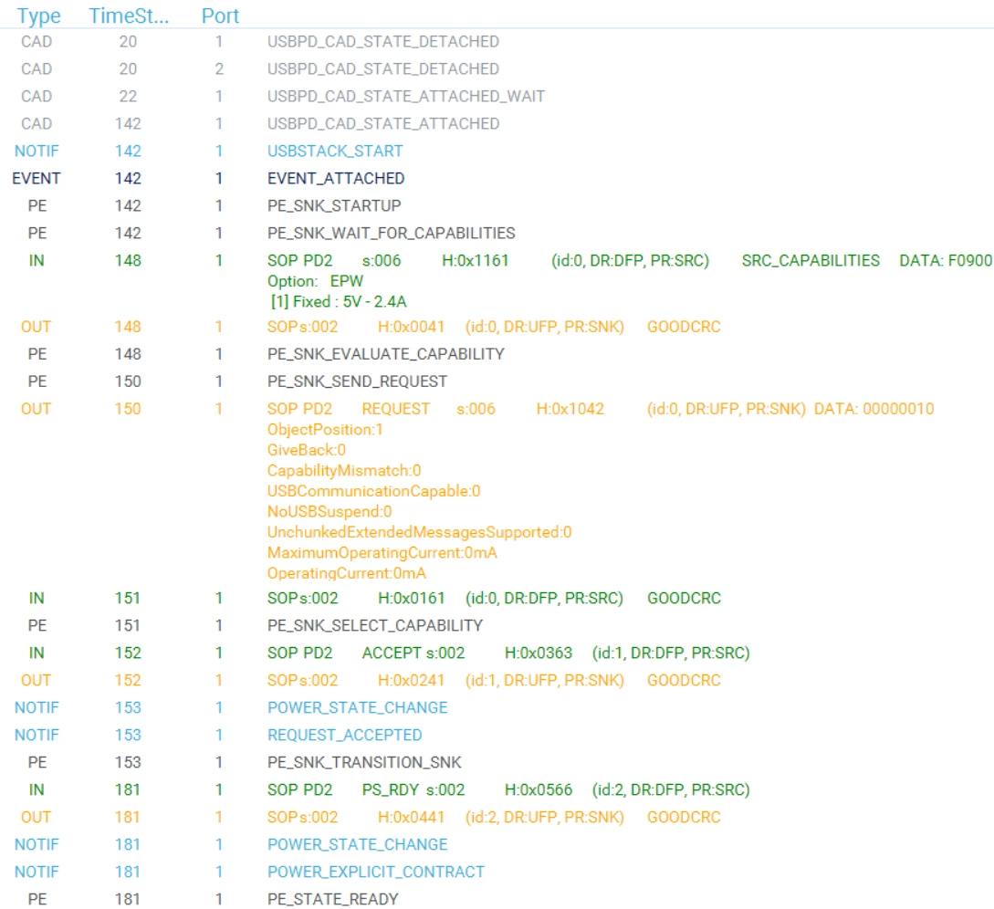

Jul 23, 2025 3:34 PM UTC
I managed to capture a renegotiation after the MCU was reset with the SNK1M1_Sink project (sometimes STM32CubeMon-UCPD disconnects after a board reset...). It appears that the protocol engine is sending a hard reset after a tTypeCSinkWaitCap timeout (that is, no source capabilities were received in time).
I am working on getting a capture for my board to see what's different.

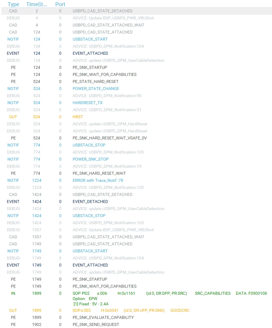

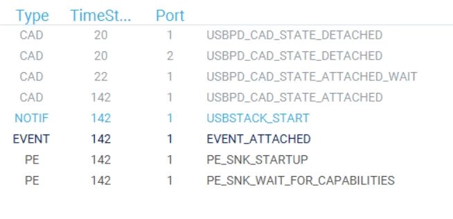

Jul 23, 2025 3:51 PM UTC
And this is the capture for my board when it is reset with a 20V/3A contract already negotiated (same setup as with the SNK1M1_Sink project above). The protocol engine doesn't seem to time out and send the Hard Reset like in the other project. Does anyone know why the protocol engine might fail to send a Hard Reset in this situation? (Spec 8.3.3.3.3: "When the SinkWaitCapTimer times out, the will perform a Hard Reset").
When it is powered up without a pre-existing contract (when the USB C cable is removed and reattached), the power supply sends the capabilities when it should and everything works:
Edit: I am seeing the same behaviour with multiple PD sources by the way. These captures were made with an Apple 60W power supply.
