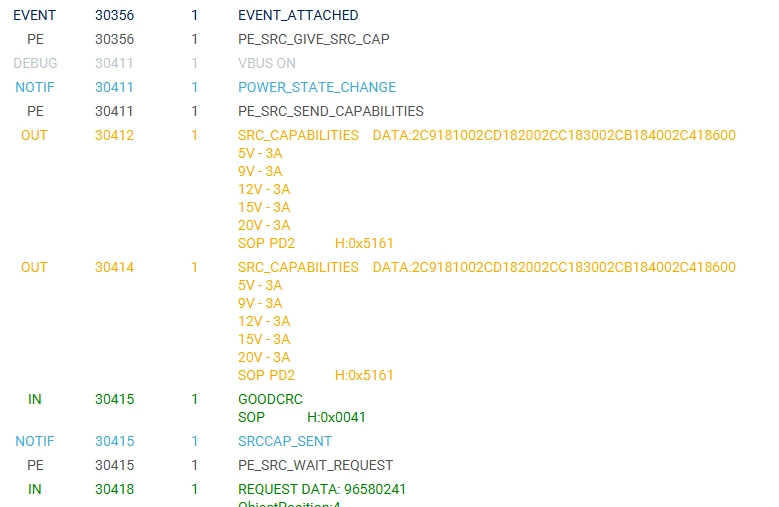

USBPD library: Source capabilities sent multiple times
I have implemented a USB-C PD source using STM32CubeMX and the USBPD middleware. When looking at the trace from TRACER_EMB, I can see that the SRC_CAPABILITIES are sent multiple times:

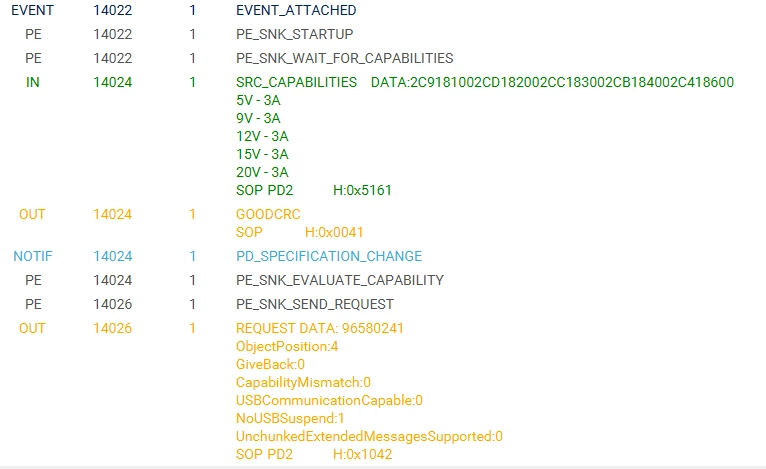

When analyzing it with the STM32G071B-Disco as sink, the SRC_CAPABILITIES are shown only once:
What could be the reason for this behavior?

Hello.
A quick explanation could be that the first source capability message wasn't received (corruption during the transmission or sink not ready at that time ?) :
we can see that there is only one GoodCRC in return.
Nicolas

ChristophR
Nov 8, 2019 11:37 AM UTC
Thanks.
I think you are right, the sink is not ready at that time. If I request the source capabilities later, the source sends the capabilities only once.
