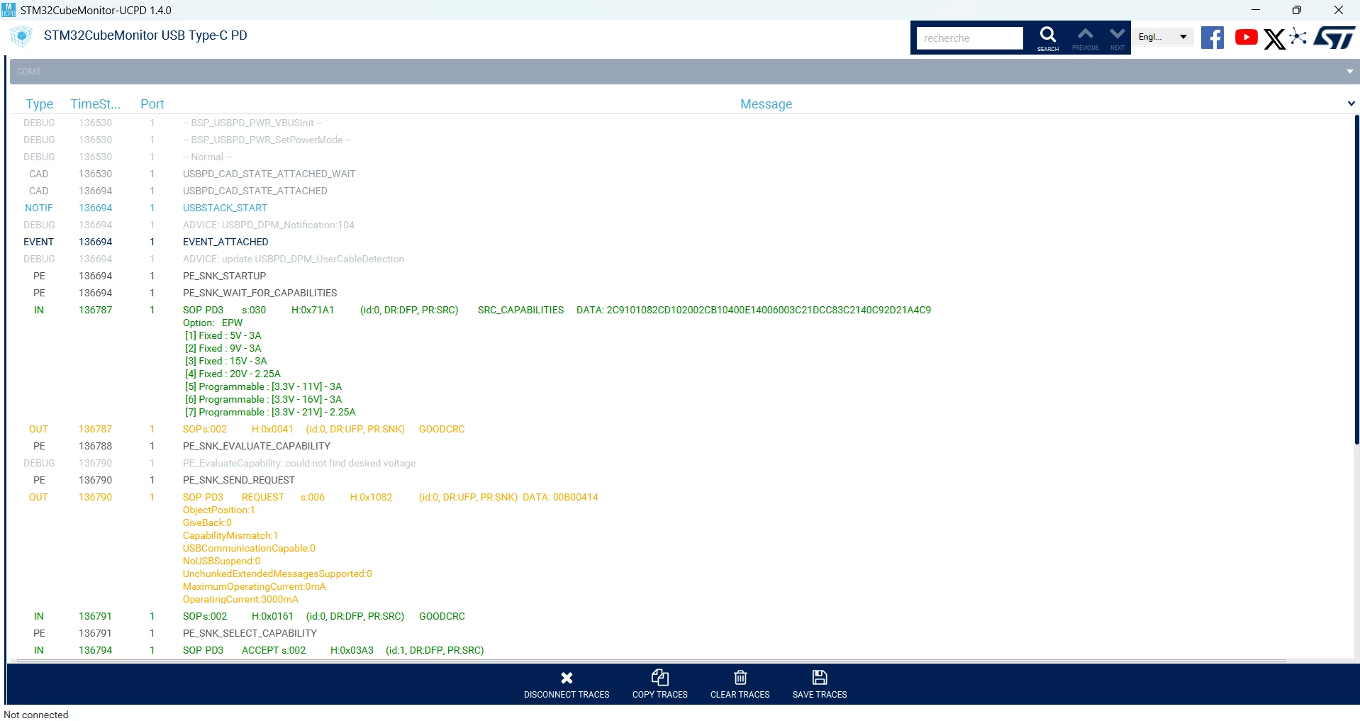

I have designed a custom board using STM32G431CB and TCPP03. I am trying to make as a sink device. I followed this video : https://youtu.be/cbdFHmMOMwk?si=GqcDTJeDxTsrFDiG
I have successfully generated and compiled the code. Also, i enabled the GUI interface and TRACE. I am able to get the trace messages in STM32CubeMonUCPD. But unable to see the GUI interface board port, I tried refreshing it several times but no luck .
Please help.

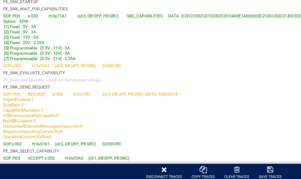

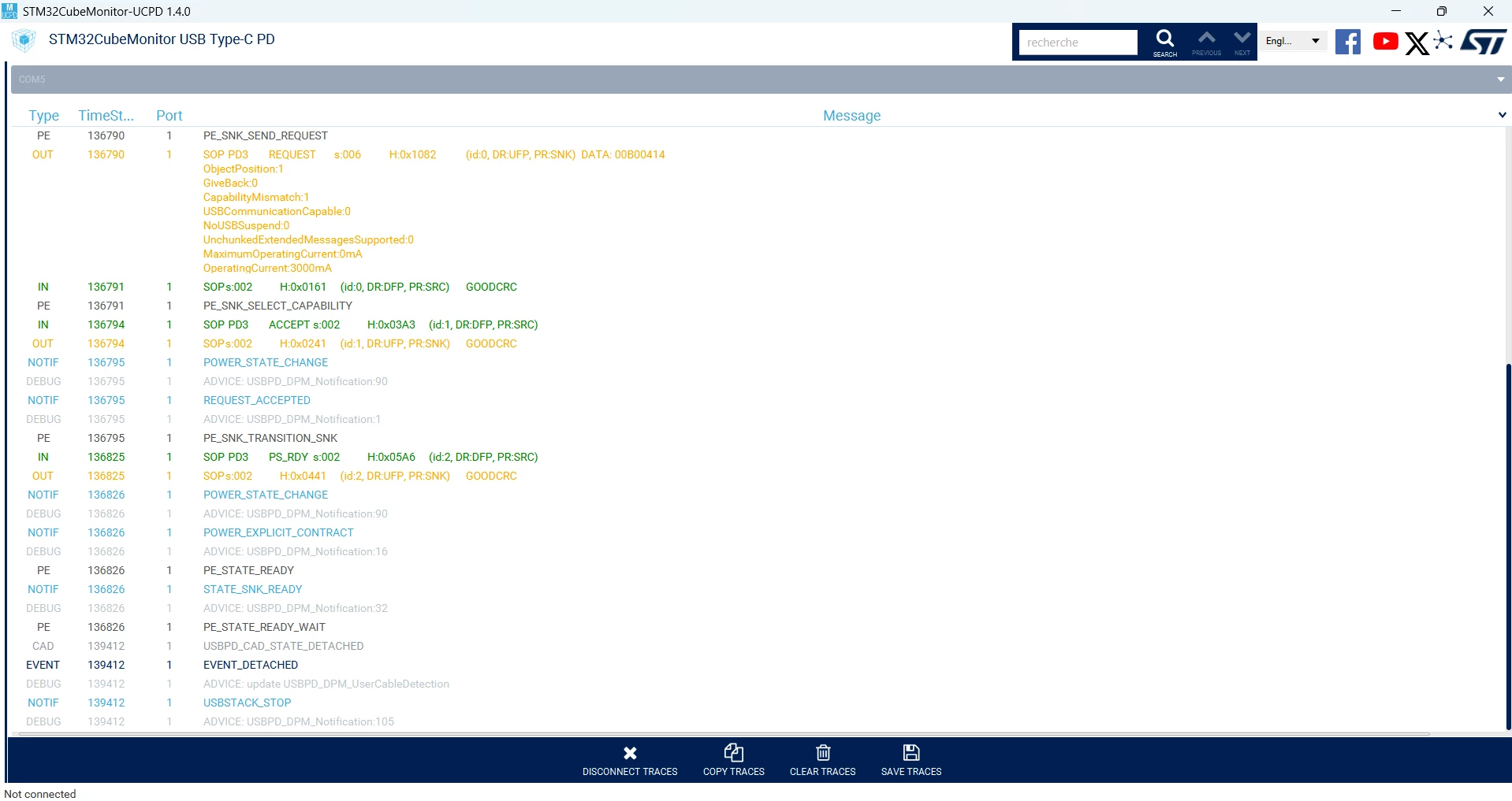

Yes, I have checked systick is working as expected. I am able to get the traces as shown below:
I am unable to get the .cpd file, just captured the traces in UCPD monitor. I am using monitor - UCPD 1.4.0
