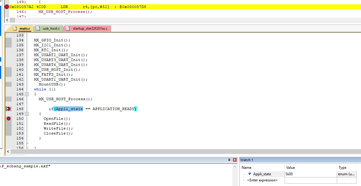

We are testing usbh mass storage using the nucleo_f207zg board.
STM32Cube_FW_F2_V1.7.0 \ Projects \ STM32F207ZG-Nucleo \ Applications \ FatFs \ FatFs_USBDisk received from the homepage is detected without any problem.

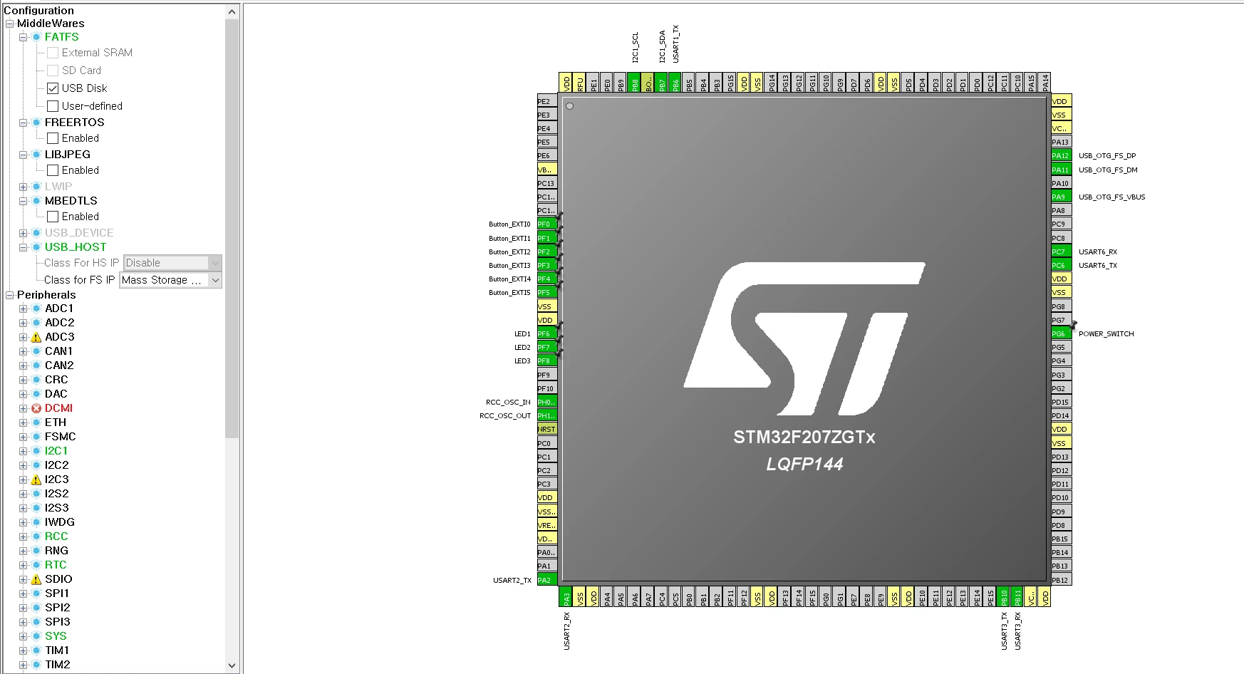

However, I created it directly as a cube (attached file) -> I tested another sample,
I can not find usb. Debugging shows that the appli_state value is still 0x00.
Does the nucleo board have characteristics? I want to solve this problem by all means.
Help !!!  I also want to design another part based on Usbh mass storage.
I attached the main / usb_host / cube file and image capture image below.
Please help me. =) Have a good day!

int main(void)
HAL_Init();
SystemClock_Config();
MX_GPIO_Init();
MX_I2C1_Init();
MX_RTC_Init();
MX_USART2_UART_Init();
MX_USART3_UART_Init();
MX_USART6_UART_Init();
MX_USB_HOST_Init();
MX_FATFS_Init();
MX_USART1_UART_Init();
MountUSB();
while (1)
MX_USB_HOST_Process();
if(Appli_state == APPLICATION_READY)
OpenFile();
ReadFile();
WriteFile();
CloseFile();
usb_host.c
extern void MountUSB(void);
extern void UnMountUSB(void);
USBH_HandleTypeDef hUsbHostFS;
ApplicationTypeDef Appli_state = APPLICATION_IDLE;
static void USBH_UserProcess (USBH_HandleTypeDef *phost, uint8_t id);
void MX_USB_HOST_Init(void)
USBH_Init(&hUsbHostFS, USBH_UserProcess, HOST_FS);
USBH_RegisterClass(&hUsbHostFS, USBH_MSC_CLASS);
USBH_Start(&hUsbHostFS);
void MX_USB_HOST_Process(void)
USBH_Process(&hUsbHostFS);
switch(id)
case HOST_USER_SELECT_CONFIGURATION:
// CLCD_Clear(&hi2c1);
// CLCD_PrintString(&hi2c1, 0, 0, ''CONFIGURATION'');
break;
case HOST_USER_DISCONNECTION:
// CLCD_PrintString(&hi2c1, 0, 0, ''DISCONNECTION'');
Appli_state = APPLICATION_DISCONNECT;
UnMountUSB();
break;
case HOST_USER_CLASS_ACTIVE:
// CLCD_PrintString(&hi2c1, 0, 0, ''CLASS_ACTIVE'');
Appli_state = APPLICATION_READY;
break;
case HOST_USER_CONNECTION:
// CLCD_PrintString(&hi2c1, 0, 0, ''CONNECTION'');
Appli_state = APPLICATION_START;
MountUSB();
break;
default:
break;
/* USER CODE END CALL_BACK_1 */
