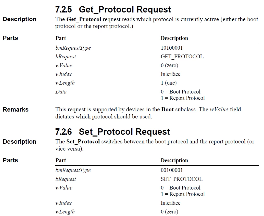

USBH_HID_SetProtocol() protocol parameter
I am using my own board based on an STM32F207ZG and STM32F2 HAL v1.9.4.
I implemented an HID Host using STM32CubeIDE (v1.19.0), simply selecting USB Host and HID class support in CubeMX and generating the code.
I was able to read key events from a standard USB desktop keyboard. However, I was not able to read any key events from a USB HID RF tag reader.
While debugging usbh_hid.c, I noticed the following:
    USBH_HID_SetProtocol(phost, 0U); generates a SET_PROTOCOL request with wValue = 0x0001  (Report Protocol)
whereas:
    USBH_HID_SetProtocol(phost, 1U); generates wValue = 0x0000  (Boot Protocol).
because this implementation:
if (protocol)
phost->Control.setup.b.wValue.w = 0U;
else
phost->Control.setup.b.wValue.w = 1U;
In other words, the protocol parameter passed to USBH_HID_SetProtocol() is inverted with respect to the value actually transmitted in the USB SET_PROTOCOL request URB.
I noticed that the same implementation is still present in STM32F2 HAL v1.9.6.
I am not saying that this is necessarily a bug, since the current implementation may be intentional and changing the meaning of the parameter would affect existing applications. However, I find the current naming/semantics somewhat confusing, especially because a call such as:
actually selects Report Protocol, while passing 1U selects Boot Protocol.
Has anyone else noticed this behavior or encountered confusion/problems related to it?
Thanks for sharing your experience.

I am not explicitly mentioning that this is a bug or issue. I just wanted to notice that this confused me (and maybe others) and maybe a more clarified explanation on the comments about what exactly does 0 and 1 as protocol parameter do.
BE AWARE: If the implementation is changed so that passing to the funciont a 0U means Boot Protocol and 1U means Report Protocol, this would also change the behavior of existing generated applications, with possibly terrible consecuences.
Therefore, I beg to think on the compatibility implications while reviewing this API parameters.

I noticed in the following link by JW that 7 years ago this behaviour seems to be detected and strange:
​@waclawek.jan said: “The "library" seeks for boot keyboard but then sets it to report mode, and even requests the report descriptor for it.”
Aug 27, 2026 3:30 PM UTC
Hi ​@JMarq.1
The code is consistent with that internal MW naming, but the parameter name is confusing.
About Jan’s post, the stack’s behavior is only consistent if it fully transitions to report mode and then parses reports accordingly. If it still later processes data as if it were boot format keyboard data, then that mismatch could explain the strange behavior seen with some keyboards.
To give better visibility on the answered topics, please click on "Best answer" on the reply which solved your issue or answered your question.Best regards,FBL

Note that the “classic” USBH library does not have USBH_HID_GetProtocol at all. Only USBH_HID_SetProtocol. The “get” request does not exist in the USB HID spec.
https://github.com/STMicroelectronics/stm32-mw-usb-host/blob/a5cc3798cd50f6b86322e7091ccf7e3eadd5be47/Class/HID/Src/usbh_hid.c#L691
The device type (HID_KEYBRD_BOOT_CODE) and support for “boot” mode is detected in the interface descriptor
https://github.com/STMicroelectronics/stm32-mw-usb-host/blob/a5cc3798cd50f6b86322e7091ccf7e3eadd5be47/Class/HID/Src/usbh_hid.c#L179
and it is not the same value as for the HID Set Protocol request. This looks like the root cause for the confusion.
https://github.com/STMicroelectronics/stm32-mw-usb-host/blob/a5cc3798cd50f6b86322e7091ccf7e3eadd5be47/Class/HID/Src/usbh_hid.c#L766
TL;DR use this library code for prototyping, then get real and find (or write) production level code.
HID device that supports “report” mode and has HID report descriptor starts in the report mode by default - even if the device descriptor has  bInterfaceSubClass =1 (“boot” interface). This value only indicates that the “boot” mode is supported.
(Note: this info is from AI!  Being lazy, hasn’t checked in the full HID spec).
To activate the “boot” mode, host sends Set Interface with wValue=0 - or as the OP proposes, USBH_HID_SetProtocol(phost, activateBootProtocol).  Again, some examples skip this step.
