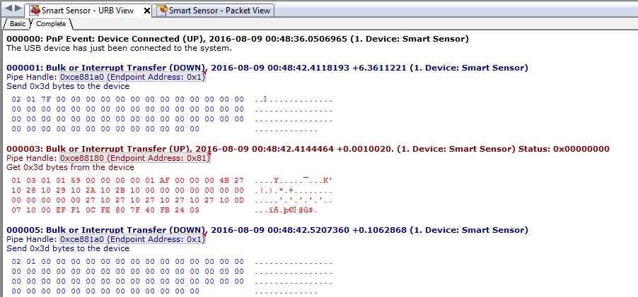

I am trying to get a custom HID device to work on my STM32F429ZI board using the USB Host driver from the latest CubeMX for F4. I have successfully received boot mode keyboard data with this driver. The intended device requires report mode as far as I can tell. The device enumerates fine and with a few modifications we make it through to the usbh_hid.cUSBH_HID_Process() state machine. As describedhttp://www.keil.com/forum/22428/stm32f4-usb-host-hid-application/
by Tsuneo Chinzei, I've added some states so that we can send data over the interrupt out EP then receive data from the interrupt in EP.

Sending appears to always work, though the buffer never changes in the receive interrupt and it always says the URB status is IDLE.
For reference, this is a working example of what I want written in a handful of lines in ruby using the HID API library:

How can I get this simple HID use case to work with the CubeMX USB Host driver?
