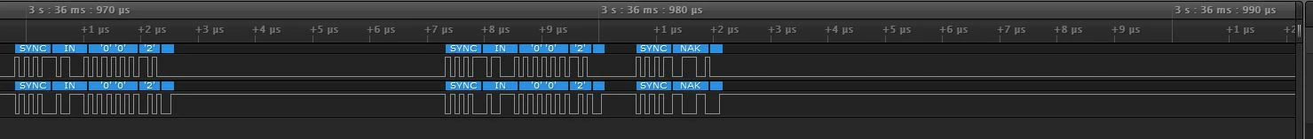

Hello All,
I am using the usbh_core module to enumerate mass storage devices as a host. I have had it work for plenty of USB 2.0 sticks (not for 3.0), but suddenly, a large batch of USB 2.0 sticks fail to work. After extending all of my delays, this seems to work more consistently, but I am still having issues, especially when inserting an extension cord.
I understand that this may be electrical, but if anyone has any good resources that outline exactly what sequence of events occur in the enumeration sequence, that would be very helpful. I have already started looking through the USB 2.0 specification, and I can see some of the critical timing requirements, but it doesn't then actually provide a complete example of exactly what needs to happen in order in terms of control requests to get from the default state to the configured state.
To me it seems like the first interrupt happens when DP goes high, then the BSP for the host waits 200ms. Then it pulls the DP line low for 100ms. Then brings it back up and waits 10ms, then it tries to communicate with the get device descriptor. Am I missing any part of this? Also, is there any issue with asking for the device descriptor repeatedly without performing a device reset in between?

Oct 21, 2019 9:45 PM UTC
Pavel,
See the attached image for the crux of the issue. I analyzed a working USB and a non-working USB. This is a screenshot of the non-working USB. Not shown here is the fact that the get descriptor message was sent, and it was followed by packets containing "address 0, endpoint 0". The last two of these "address 0, endpoint 0" messages are shown here. In a healthy connection, each of these messages is followed by a nack until the device responds with the device descriptor. In this communication, only the last message was nacked, and then the messages end abruptly. I am looking further into packets and what they typically contain, but I am on the right track.

ZThatAuthorBest answer
Jan 3, 2020 9:15 PM UTC
The root of all of this intermittency was that the 48MHz clock used for USB was actually running at 50MHz. Be careful when using the CubeMX example code as a starting point for an application that uses the 48 MHz clock for multiple purposes that the 48MHz clock isn't being set to 50MHz. 48 should work for both the SD card and the USB. 50 only works for the SD card.
