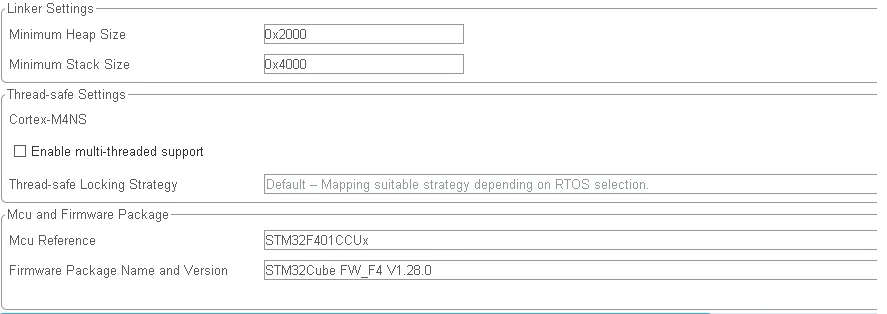

Selected the STM32F401CCU6 in MCU and have configured the clock to 84Mhz.

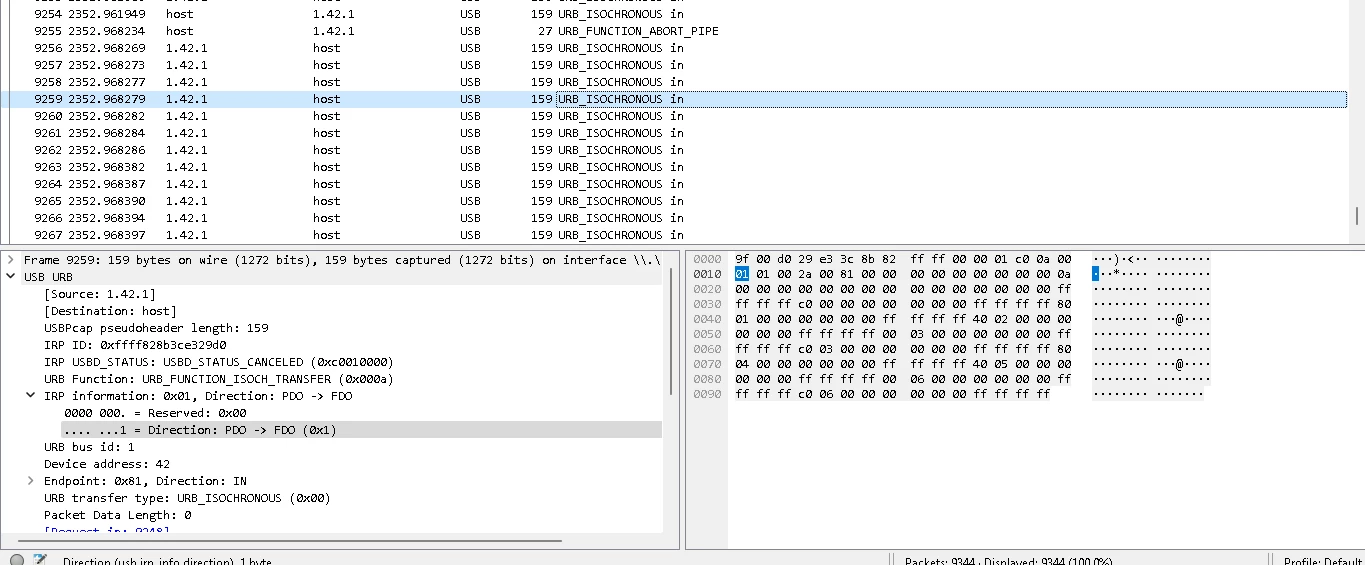

Even after the device is detected correctly , I am unable to transmit the packages, also the DATAIN callback is never called.
After analysing the code , it is found that the "transfer complete interrupt" is never set and hence the DATAIN callback is never called.
The data packets are monitored on the Wireshark , below is the screenshot
It seems that the PC is requesting the data , but the device never responds with the packet because the DATAIN is not called.

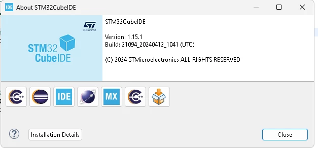

I am using STM32CubeIDE version 1.51.1
The firmware version for STM32F401CCU6 firmware version is V1.28.0
