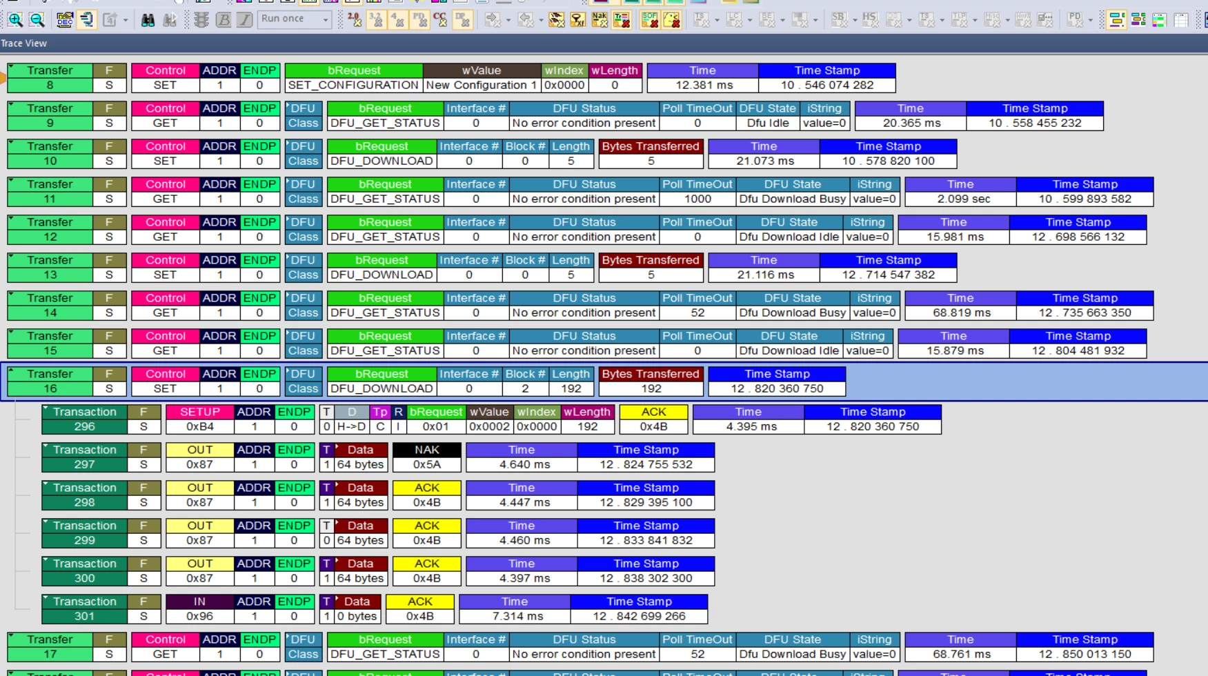

Hello ST Team,
I developed a custom USB DFU HOST class on an STM32F446ZE. I soldered a USB-C cable directly to the D+/D-, 5V and GND pins.
The Problem: The stack works correctly for transfers up to 128 bytes. However, when I set phost->Control.setup.b.wLength.w > 128 (e.g., 192 bytes) and call USBH_CtlReq, the code enters an infinite loop inside USB_WritePacket.
I have traced the execution line-by-line, monitoring the HCTSIZ register values: size (Transfer Size) and cnt (Packet Count).
Below is the detailed trace comparing a working 128-byte transfer vs. a failing 192-byte transfer.

2. Failing Scenario: Transferring 192 Bytes
Initial State: size = 192, cnt = 3.
Loop Iteration 1:
  • i=15: USBx_DFIFO written. Register updates: size = 128, cnt = 3.
  • i=31: USBx_DFIFO written. Register updates: size = 64, cnt = 2.
  • i=47: USBx_DFIFO written. Register updates: size = 64, cnt = 1.
Loop Iteration 2 (Anomaly Begins):
  • Initial State: size = 128, cnt = 2
  • i=15: USBx_DFIFO written. Register updates: size = 128, cnt = 2.
  • i=31: USBx_DFIFO written. Register updates: size = 64, cnt = 1.
    •  cnt value didn't change in last transfer?
Loop Iteration 3 (Corruption & Infinite Loop):
  • Transfer initialized with: size = 128, cnt = 3
    •  cnt value set to 3 again?
  • i=31: USBx_DFIFO written. Register updates: size = 64, cnt = 3.
    • cnt value is now stuck at 3.
  • i=47: USBx_DFIFO written. Register updates: size = 64, cnt = 3.

Jun 22, 2026 18:43 UTC
Hi ​@Strongato
We found a bug in the host channel toggle handling for multi packet USB transfers.
The issue was that the code was updating the toggle_in / toggle_out state using only the transferred byte count, which was not always enough to correctly determine how many USB packets had actually been sent or received.
This caused the DATA0 / DATA1 PID to become incorrect after some transfers, especially when:
  • the transfer length was an exact multiple of the endpoint max_packet,
  • the last packet was a short packet or zero-length packet,
  • or the transfer was split across multiple transactions.
As a result, the device could detect a data toggle error, which is exactly what we saw in the USB analyzer.
Fix will be implemented in HAL in HCD_HC_OUT_IRQHandler, the toggle update was previously limited to only interrupt and bulk endpoints. Now, we add control endpoints, if (hhcd->hc[chnum].ep_type != EP_TYPE_ISOC) for all non isochronous endpoints, toggle handling is applied. So control transfers use correct PID sequencing when they have multiple packets.

StrongatoAuthor
Jun 23, 2026 07:56 UTC
Hi ​@FBL
Great discovery!!!
Unfortunately I couldn’t get it to work on my machine, I’m using the HAL version 1.8.5

Jul 30, 2026 09:37 UTC
 Hi ​@Strongato
Can you test this patch also in control transfer in CTRL_DATA_OUT ? The workaround proposed is valid for non DMA   Keeping one packet per HCD request makes a NAK retry independent of the FIFO state.  Attached HCD file, as well to for data toggling covering control transfers.
