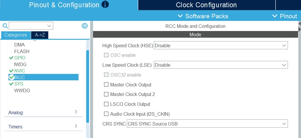

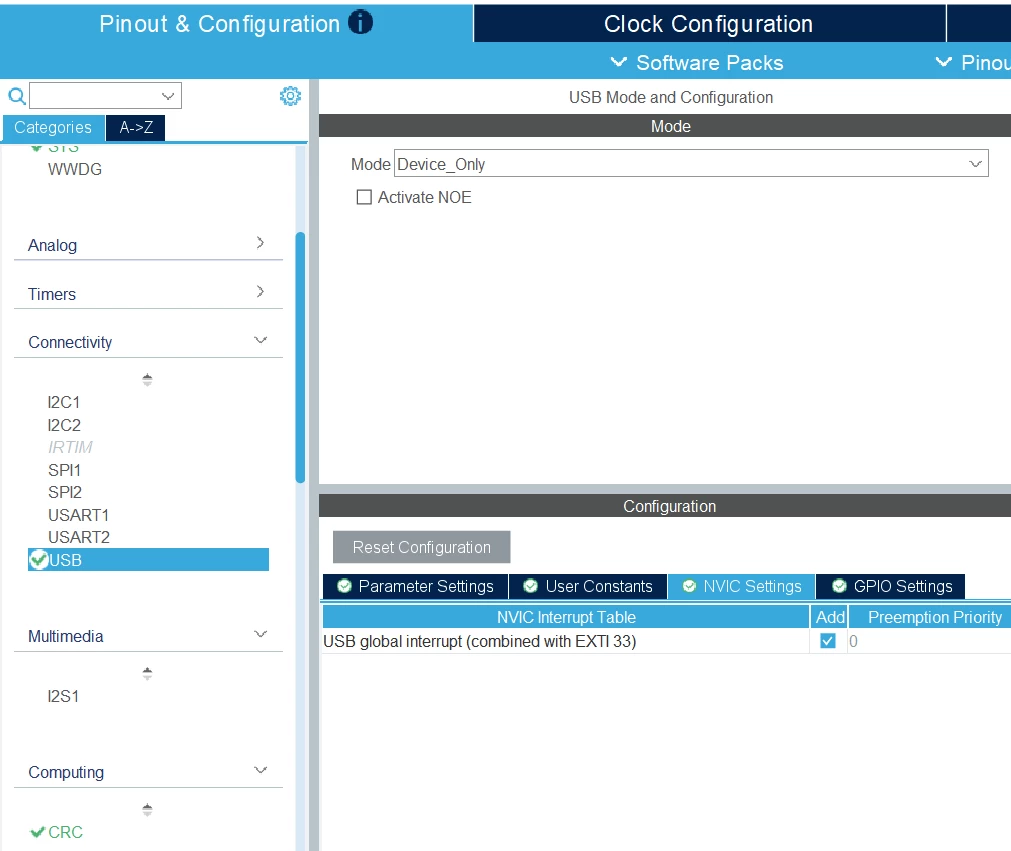

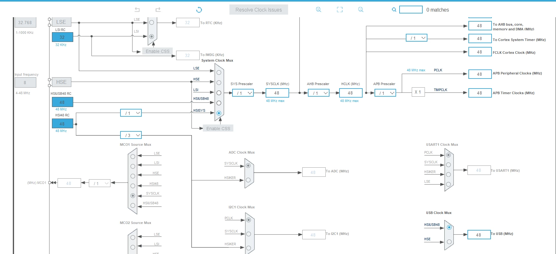

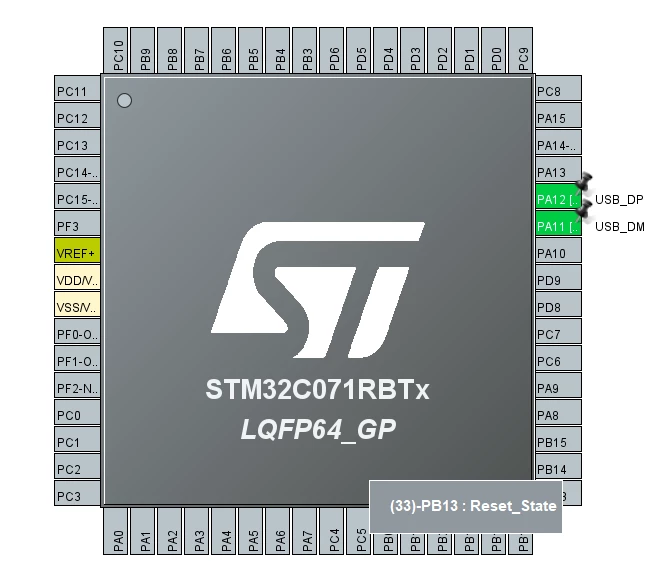

I’m using NUCLEO-C071RB board and this are the settings with Cube MX:

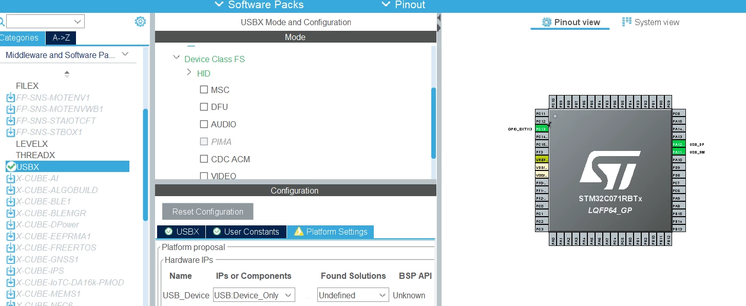

I tried STM32Cube_FW_C0_V1.4.1\Projects\NUCLEO-C071RB\Applications\USBX\Ux_Device_HID_Standalone, because i think is good for my application but dosen’t work:
Double click on .project, build/run:
I hear the Windows sound when i connect the USB cable to computer, but no new COM appears, and there is no error message like “USB not recognized”.

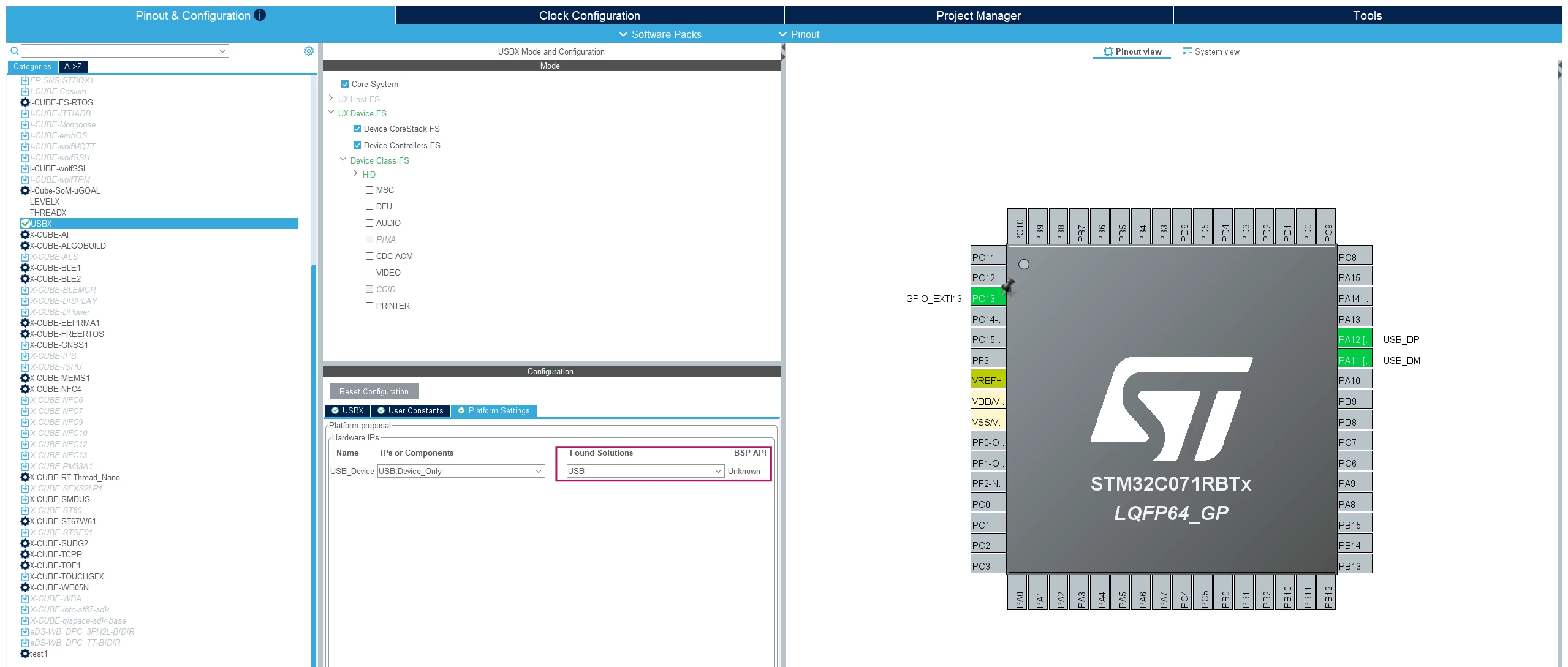

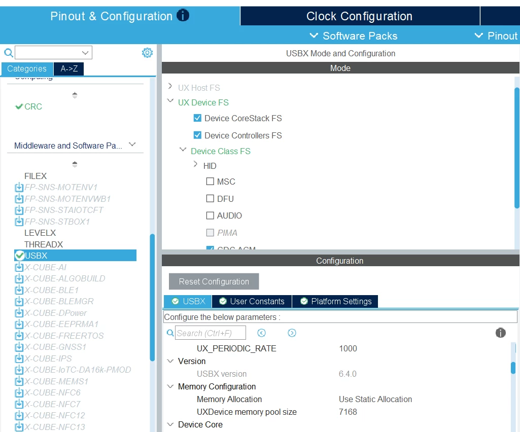

I open the .ioc project and i found this warning:
Sep 7, 2026 8:41 AM UTC
Hello ​@AndrewFFFF
Further to your comment, you need to set the Found Solutions as USB.
Thanks.

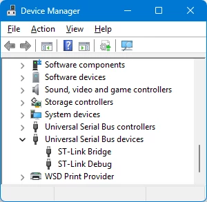

What does Device Manager show?
Nothing. I only hear the sound and see some refresh (inside Device Manager), but nothing else—no error and no COM port.
Does anything appear under ‘Universal Serial Bus devices’ ?

Feels like Ux_Device_CDC_ACM would be a more appropriate project. HID will not give you a com port, but rather a HID device. No doubt it shows up Device Manager somewhere if you heard the connect sound.
The HAL USB support has been historically lacking. For RealTerm, ensure the STM32 code handles and changes the com port settings (baud rate, parity, etc) and reports them back correctly.

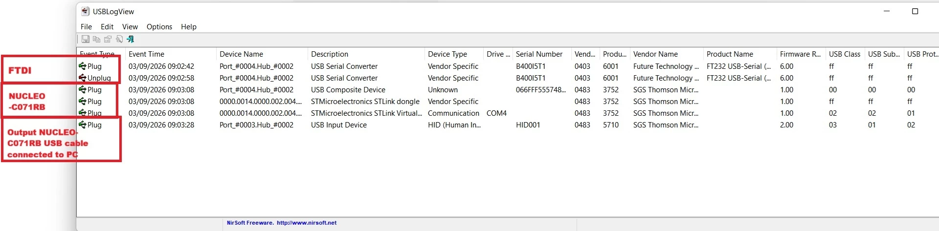

I copy here the USB event for STM32Cube_FW_C0_V1.4.1\Projects\NUCLEO-C071RB\Applications\USBX\Ux_Device_HID_Standalone:
The USB cable works properly. I usually connect it via a HUB, but the issue persists when connected directly to the computer.
So that’s still the HID project - it will not give you a COM port.
It does seem to be correctly enumerating as an HID device ?

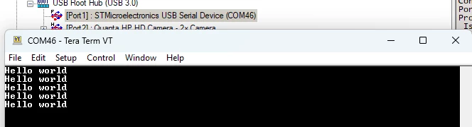

Hello ​@AndrewFFFF
Here is a ready-made project that configures the STM32C071 as a USB CDC ACM device in standalone mode. It repeatedly sends "hello world" to the serial monitor. It can be used as a reference to debug another project and identify the root cause.
I will attach it in this reply
BR
Gyessine
Sep 8, 2026 8:19 AM UTC
Thank you Gyessine it works fine.
