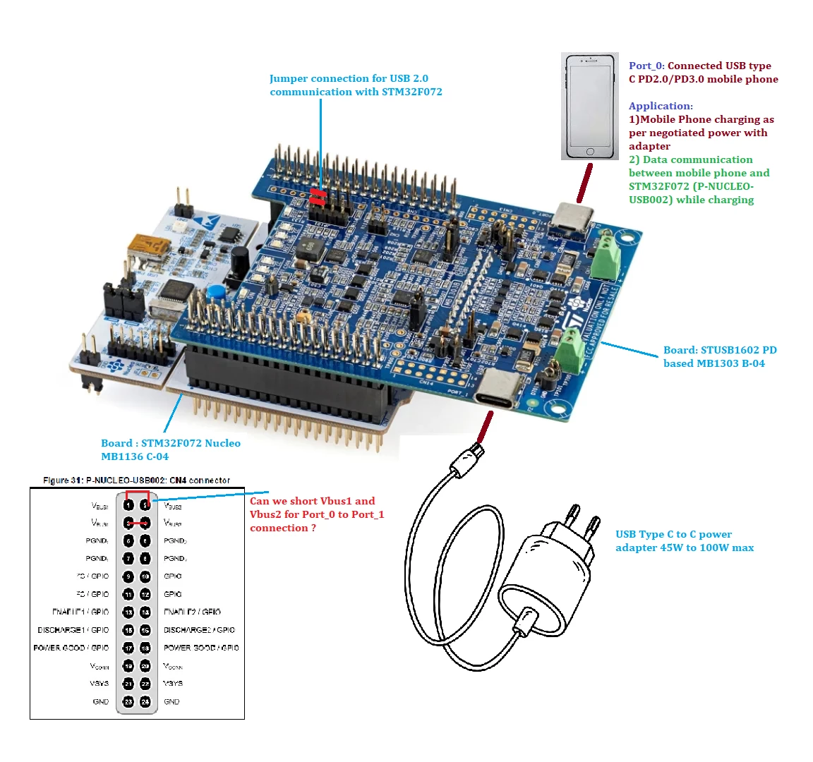

I am new to firmware development and using the P-NUCLEO-USB002 USB type C board for pass-through charging.
I have identified the few hardware settings for the pass-through charging and data communication between USB type C Port_0 and Port_1.
- connected mobile phone to Port_0
- connected PD charger to Port_1
- Power Connector CN4 Pins shorting done for Vbus1 and Vbus2 connection
- Removed the jumper connection of JP401 and JP400
Please suggest for below queries.
1) Can we use this pass-through for mobile charging between Port_0 and Port_1?
2) Is there any demo firmware for the Pass-through charging between Port_0 and Port_1?
3) How to check the status of the PD connection or messages using UART/I2C? ( default firmware received with kit were modified with STSW_STUSB010_v1.3 example codes, But unable to get PD messages on UART. if STSW_STUSB010_v1.3 example codes do not support the UART/I2C debug then please provide the default firmware of the P-NUCLEO-USB002).
4) Can we control and make the decision based on PD messages of SPI/I2C communication between STUSB1602 and STM32F072 controller to control the GPIOs?
please find the attachment.
Please suggest.

To check PD messaging you can use our UCPD monitor https://www.st.com/en/development-tools/stm32cubemonucpd.html which uses UART to output the trace (take care to connect provided wires between CN2-TX of stusb1602 board and CN3-Rx of the nucleo)
As per the picture shared, port0 has source role and port1 has sink role.
You need to refer to schematic for power connection: seems that CN4 pinout you pointed out is not in line with schematic. To fit with your example, I do suggest to
* remove JP401 and JP400
* connect JP001and JP00 to position 1-2 (they are already correct on your picture)
* Then I suggest to connect CN12 (Vbus of port 1) to powconn1/3 of CN4 (pins 1 & 3) which will be the 'input supply' for port0 acting as a source.
About your last question about controlling GPIOs: you can add some GPIO settings based on 'usbpd_notify_xx' from usbpd_dpm_notification function.

As suggested, I have done the same setup and facing the issue. please suggest.
Without Jumper JP400 and JP401 device through the "Dual Role Port - Unplugged" message.
I have attached the log of the testing setup, using demo firmware (MB1303_Demo_DRP_CLI.zip).
test details and commands added below, commands for the same are highlighted for your reference.
setup condition 1:  When JP401 and JP400 are Connected.
with setup condition 1, able to change the power profile of the charging adapter at port_1 and able to change the power role of swap of mobile phone from sink to source and vice versa.

setup 2:  Removed JP401 and JP400
With setup condition 2, able to request/change the power profile of charging adapter at port_1 but not able to connect the port_0 with the mobile phone.
Logs for setup condition 2:
>status 0
Role: Dual Role Port - Unplugged
>prswap 0
Warning : power role swap not sent, missing explicit contract
>prswap 0
>prswap 0
>prswap 0
>status 0
please suggest, how to use this board for the Pass-through charging application, with power role and data role swap.
