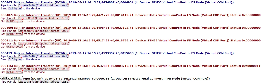

It seems that there are 0x40 bytes missing in the last transfer so the host resets the endpoint.
waldi
waldiAuthor
August 12, 2019
Packet count is 1, that means one packet is still not emitted? It would explain 0x40 difference.0690X00000A9QfrQAF.png
