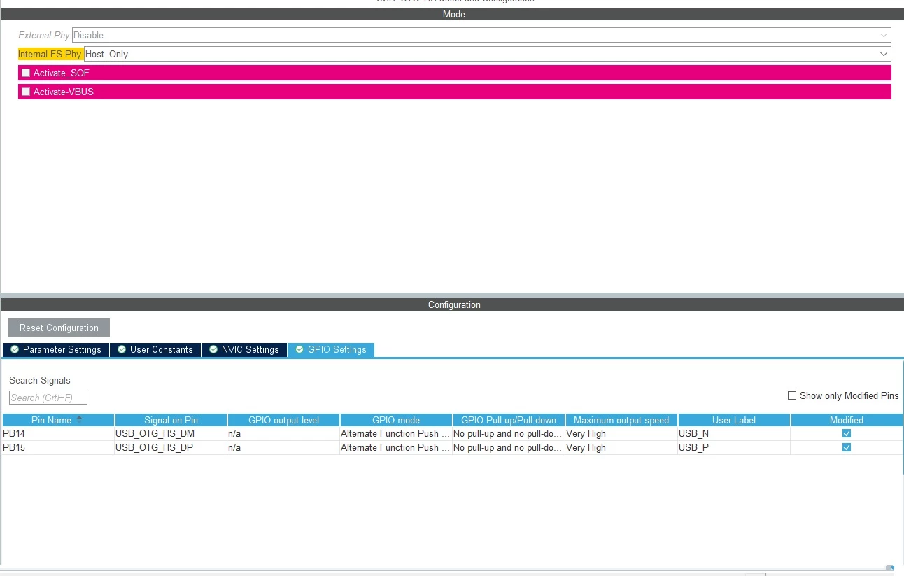

Usb stick Reading..

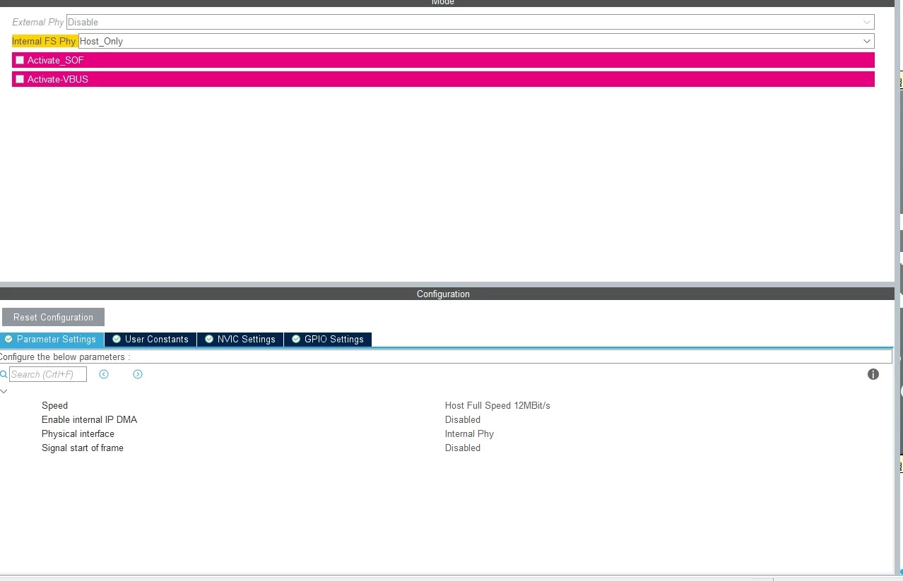

Hi guys.. I am trying to read the usb stick with STM32F746... I am always stucked becasue it doesn't read anything... Can you please help me ?
Thanks a lot

Hello @SGasp.1​ ,
Take a look at the following example provided in our F7 Firmware Package ( Path : Projects\STM32746G-Discovery\Applications\USB_Host\MSC_Standalone )
To select the appropriate USB Core to work with, you must add the following macro defines within the compiler preprocessor (already done in the preconfigured projects provided with this application) :
   - "USE_USB_HS" when using USB High Speed (HS) Core
   - "USE_USB_FS" when using USB Full Speed (FS) Core
This may help you.
BeST Regards,
Walid
