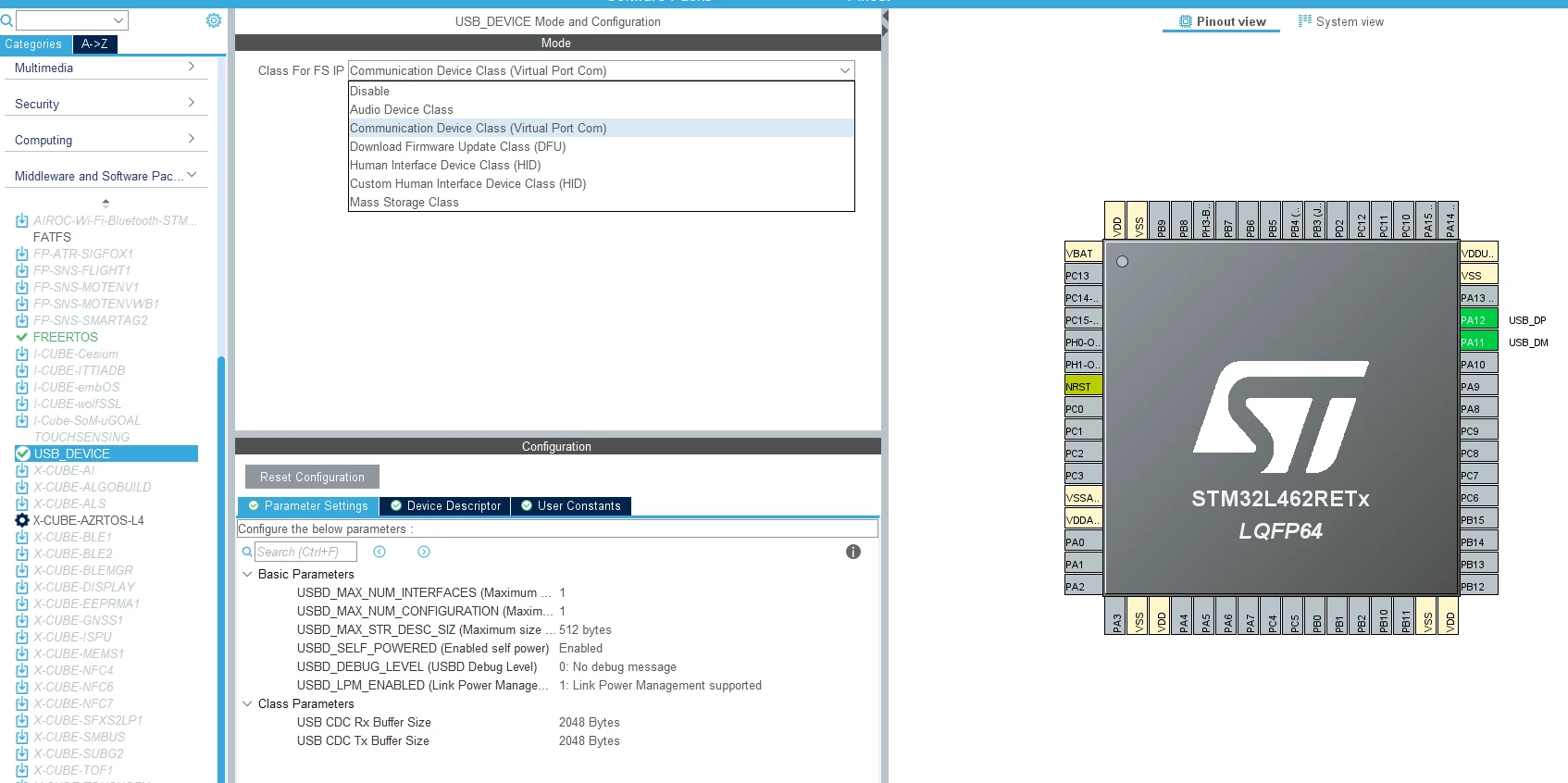

USB RNDIS + USB VCP on STM32L462
Hi, I would like to enable RNDIS + VCP on this MCU. Is there an option to do that?
I do not know how to enable only RNDIS for this MCU too (I do not see this on drop down with Class for FS IP).

Try the X-CUBE-AZRTOS-L4 package,  Under USB/USBX it has CDC ECM and RNDIS options.  I haven't yet used AZRTOS but a co-worker has and he get CDC ECM (a different Ethernet-over-USB protocol) up and running in a NUCLEO board in a day.  Otherwise, you will likely have to manually port RNDIS from another STM32 family (I don't recall which ones ST has RNDIS support, if any).

Hello @dnj,
The RNDIS class is provided with STM32CubeL4 MCU package. You can find it under:
 \STM32Cube_FW_L4_Vx.x.x\Middlewares\ST\STM32_USB_Device_Library\Class\CDC_RNDIS\
You can start from CDC project, then modify it to the RNDIS structures und modules.
Please refer to the wiki page: Introduction to USB with STM32 - stm32mcu: 5.3.2.6 CDC Remote Network Driver Interface Specification (RNDIS) Sublass.

So, I have to do it manually as you mentioned and @Bob S too.
Then I have another question. Is it possible to run both (VCP and RNDIS) CDC? By run both I mean both are active at same time.
