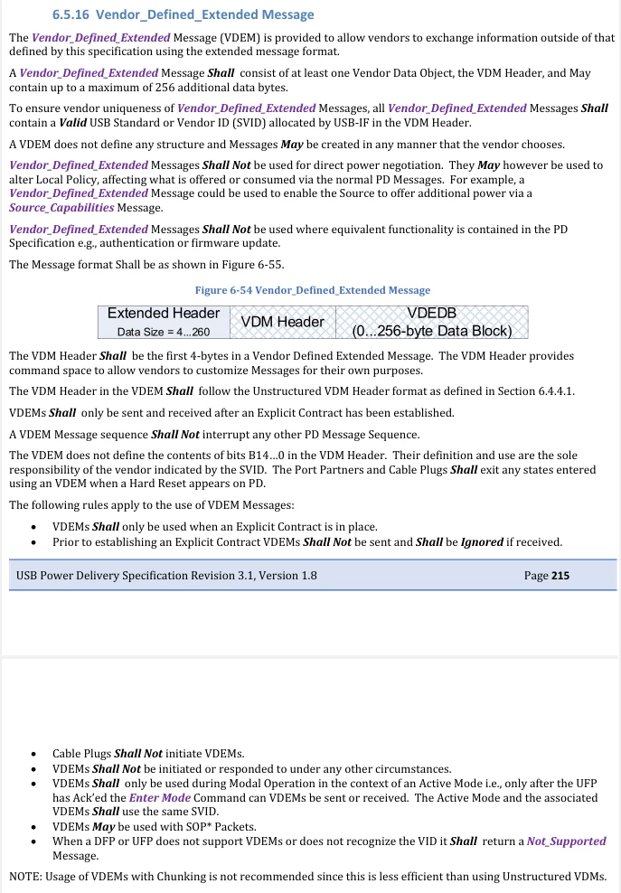

Hi Community!
We're working with an STM32G0B1xx MCU and using USB PD v5.0.0 library from github (https://github.com/STMicroelectronics/stm32-mw-usbpd-core).
I see here that USBPD_EXT_VDM = 0x1E is defined properly. However, when I use this with USBPD_DPM_SendExtendedMessage(), I get a generic "USBPD_FAIL" response, and nothing gets sent out on the CC line.
So, my question is: Does the v5.0.0 library support Vendor_Defined_Extended message?
Thank you for the support!
Screenshot from the USB PD 3.1 spec
2 replies

Hello @DDesr.1 ,
Do you mean the call to USBPD_PE_SendExtendedMessage() returns USBPD_FAIL ?
If so, it is expected as Vendor_Defined_Extended messages are not supported in v5.0.0 of USBPD Core library.
Regards
DDesr.1
DDesr.1Author
Aug 4, 2023 6:34 AM UTC
Hi @Guenael Cadier thank you for responding.
It's too bad.. I could really use the feature :).
Please, let me know if there's anything I can do to help expedite this one .
Thanks again
