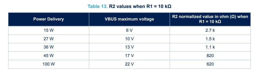

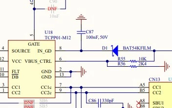

Mar 3, 2026 07:03 UTC
Hi AWack
For the Nucleo-H653 board, you will find a working .ioc file attached to generate the project. It includes a 20V 100mA PDO.
By connecting a 20V capable USB-Type C charger, the software negociates a 20V. You can verify with STM32CubeMonitor-UCPD.
But, on this hardware, the TCPP01 OVP is set to 6V (R56 = 2.4kOhms), then when Vbus=20V it opens the Vbus path.
So you can replace R56 by a 620 Ohms resistor to increase the OVP to 22V.
Warning: It is now possible to have 20V on the board, NEVER place the "PWR SEL" jumper in the "USB USER" position, as this may damage the board and/or your computer.
I have experimentally validated this solution on my end, please let me know.
Best regards
PPAIL.1
